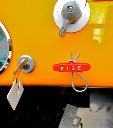

Some important points: First off, whatever you decide for mounting, rfn026's suggestion about learning how to properly use a fire extinguisher is absolutely correct. After over 40 years as a professional firefighter, I can't tell you the number of times we rolled up on what started as a very minor engine compartment fire, but the vehicle had burned to the waterline . . . either because the driver didn't have a fire extinguisher, or (all too frequently) did have one, but had no idea how to use it effectively, if at all. OK, having said that, where to put the darned thing? Another important point, which has been mentioned - whatever you decide - make sure it's properly secured. I mean REALLY secure. You don't want that thing flying around the car interior in a collision. Next, make sure it is QUICKLY ACCESSIBLE. I'm not sure any location you have to get out of the driver's seat - or even the car - to get to is your best choice. If my 1962 started smoking from under the hood, I want to be able to grab it and use it as quickly as possible. In a fire, the clock is already running before you see a problem. Time is your enemy. And finally, don't fall into the trap the if a small extinguisher is good (and it is), a big one is better and a huge one is best. You should not be fighting a well-involved vehicle fire with a hand extinguisher. If your small one doesn't put it out, get the hell away from the car (You DID call the fire department right away, didn't you?). Increasing your chances for a happy ending involves all of the above - buy a quality extinguisher (mine is Halon), don't go overboard on size, mount it securely in an easily accessible location, and make sure you know how to use it. Good luck, and I hope you never need it - for your car, or someone else's.

Yes, Halon is rated for Class B (flammable liquid) fires. You do NOT want to use Halon in any tightly enclosed area as it displaces oxygen and does not support life. Just like the old Carbon Tetrachloride extinguishers from years ago, if you stick your head into a tight space to discharge the extinguisher, there is the chance you could be overcome. That's the reason that computer rooms that used Halon dump systems had a time-delayed activation device coupled with an evacuation alarm to alert any occupants to eave the area. Under-hood fires (the most common) are a safe area to use Halon extinguishers. Under the dashboard, just stay outside the car in the fresh air and direct the extinguisher onto the fire area.
