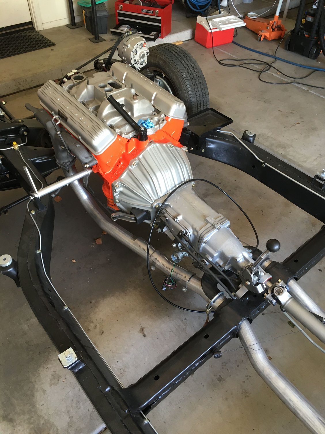

I've made quite a bit of progress on my 65 roadster. My question is....I want to start my engine on the frame before the body goes back on. I know you'll see that I still need to add some finishing touches before this happens. Does anyone know how to "quick-wire" the engine to do this? I know they sell a push button starter, but not sure how to wire it in. YouTube will probably have an answer, but I want the corvette experts to chime in!

Thanks JohnZ! That's exactly what I need. Since I'm close to putting the body on, I may as well make sure the engine doesn't have any major issues. Although it's had a total rebuild, you never know!
