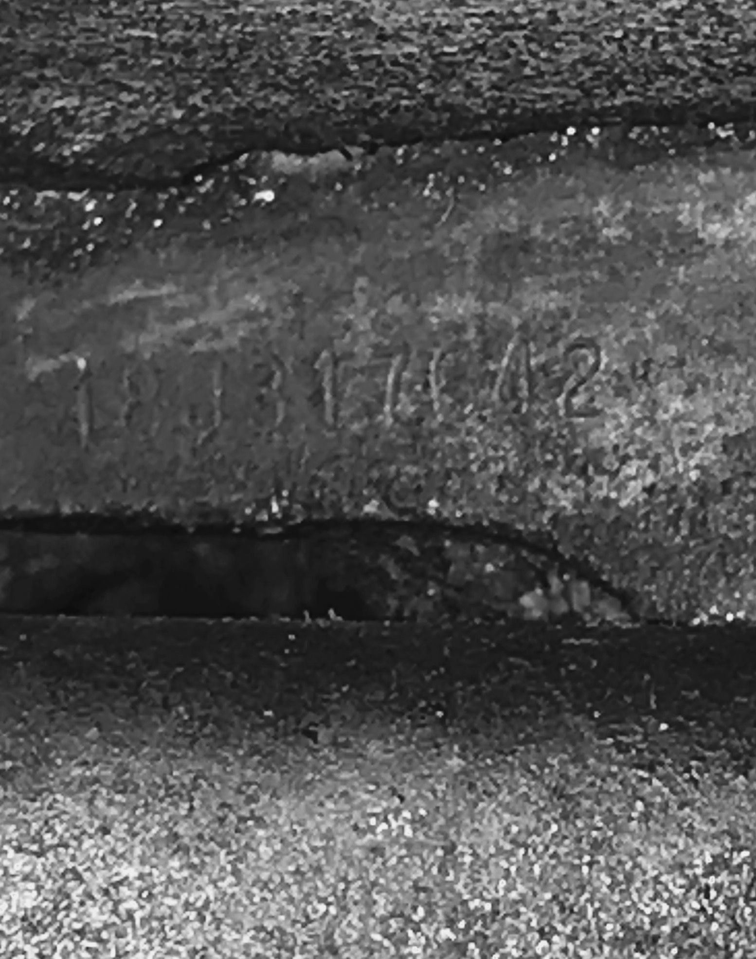

I need help decoding a 1958 corvette engine T0716HN. The engine also has a Chevrolet Tonawanda the number 1 team placard on valve cover.

I used this decoder and these are the results...
http://www.thecamaro.com/Decoding/Ch...inedecoder.php
1965
Corvette
327cid, 4Spd. Trans, FI, TI.
375hp
HN
1968
Chevrolet
327cid, 4BC, Reg. Fuel and Powerglide.
250hp
HN
1969
Chevrolet
350cid, 3Spd. Auto trans. TH350.
300hp
HN

The T in the build stamp indicates the block is a Tonawanda NY built engine so we know it didn't start it's working career in a Corvette.
I can see a partial casting number of the intake manifold. It appears to be 391980_. This 3919 sequence indicates a 1968 time frame. If the carb is a 4bbl I am guessing the casting number is 3919803, which is a 1968 only intake used on all V8 body lines. If the casting number is 3919801 then it is a 2bbl intake used only in 1968 primarily on 307s and '68 Camaro 327s.
Once again a block casting number and date would help clear up the identity of this mystery engine.

18J317642

Looking more like a 1968, 327 (?), full sized Chevy or Chevy II with powerglide...

That stamp looks like 18J317042.
If so, it makes this a 1968 engine installed in a car at the Janesville, WI assembly plant.
Janesville made full size passenger cars, so you engine is a 1968 327, 250hp, powerglide, 4 bbl carb, installed in a full size passenger car

HN either a 1965 ,327 ,375HP ,FI ,MT ,TI Corv. or 1969 350 ,300 HP ,4B THM 350, PASS so it depends on the year.
