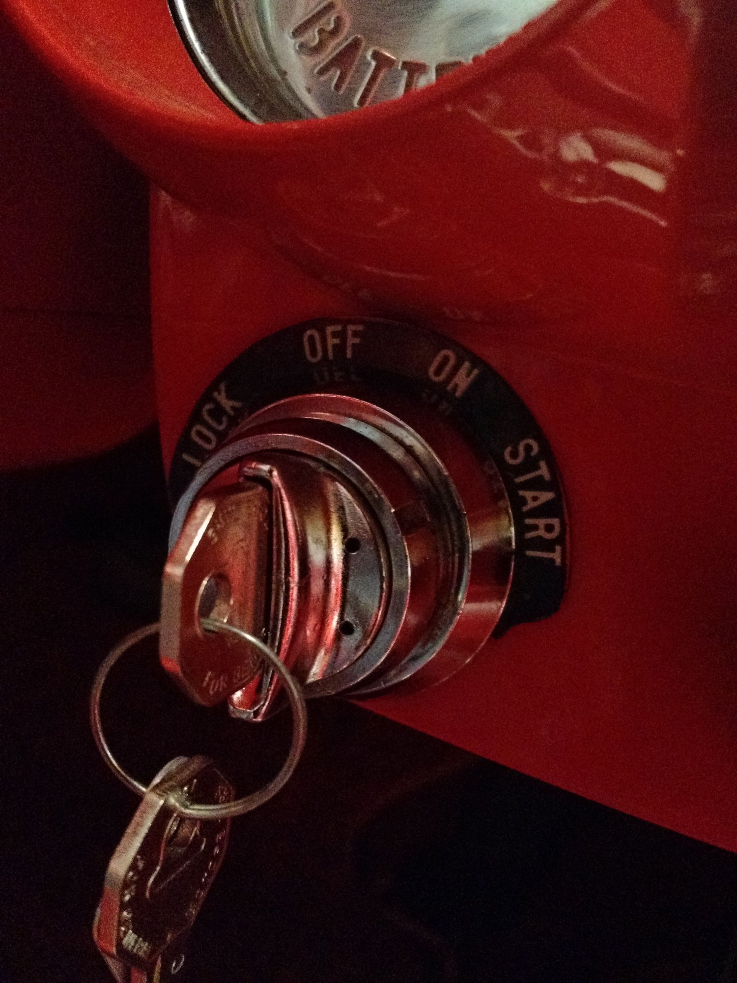

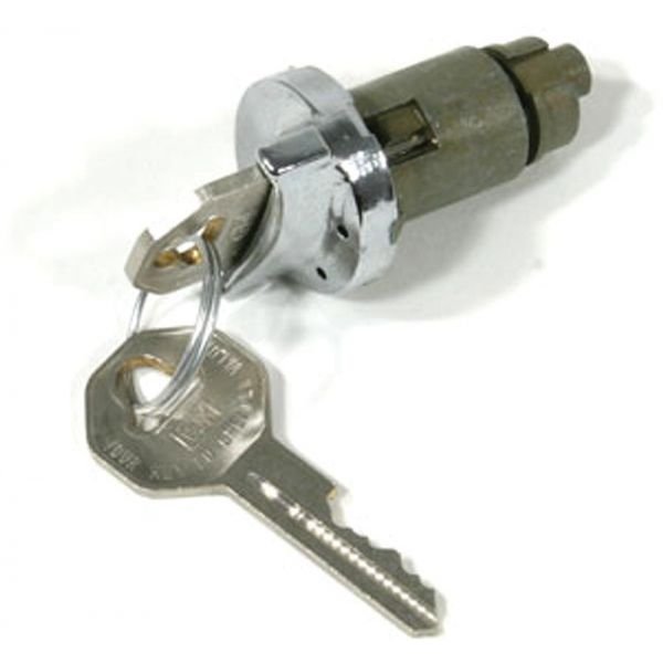

I needed to replace my ignition lock assy on my 1960. I have tried 3 brands, Standard, Locksmart, and don't remember the other. They look exactly the same as original, except for the chrome face cap (finger grabber thingy) which will not fit inside the nut that holds it all together. It's such a tight fit that you cannot turn the key. The nut and spacer, and ignition switch assy appear to be original. Short of removing the chrome face cap, or trying some filing, does anyone have any experience with this replacement that would shed some light on the problem? The old lock had the chrome piece missing and this may be why. If I hold the lock nut in my hand and try to insert the tumbler/lock ***'y into it, I have to force it in and then of course it won't turn. Any help from the C1 group?

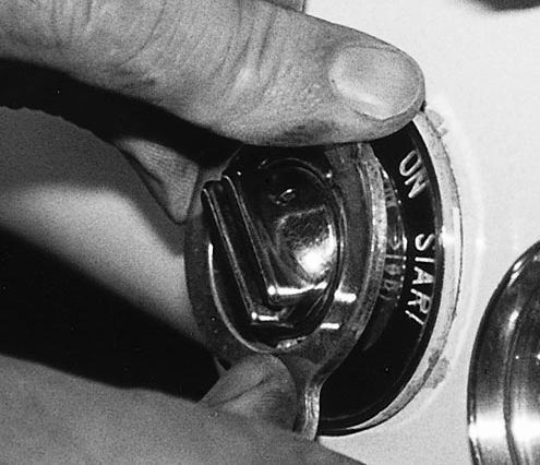

For clarification, this cylinder with chrome face:
Won't slide inside the edge of this nut:
So that it fits like this:

You are aware that the nut won't slip over the lock if the lock is inserted first in the ignition switch, aren't you? The switch (without the lock) is first installed from the rear, then the nut is tightened. Then the lock is installed from the front.

When installed in the dash...you can't unscrew the bezel without the lock cylinder removed.... That doesn't explain why the tumbler with the finger tab shouldn't turn easily within the bezel outside of the dash IMO...

It is the entire circumference of the Chrome piece that is part of the finger tab. Rubs inside the nut
all the way around. I tried an Echlin brand today, same result. I've already started filing on it and it's getting better, I'll keep going until it's free.
