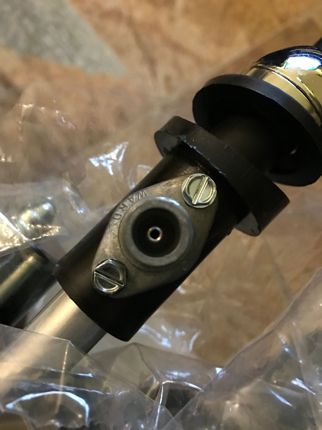

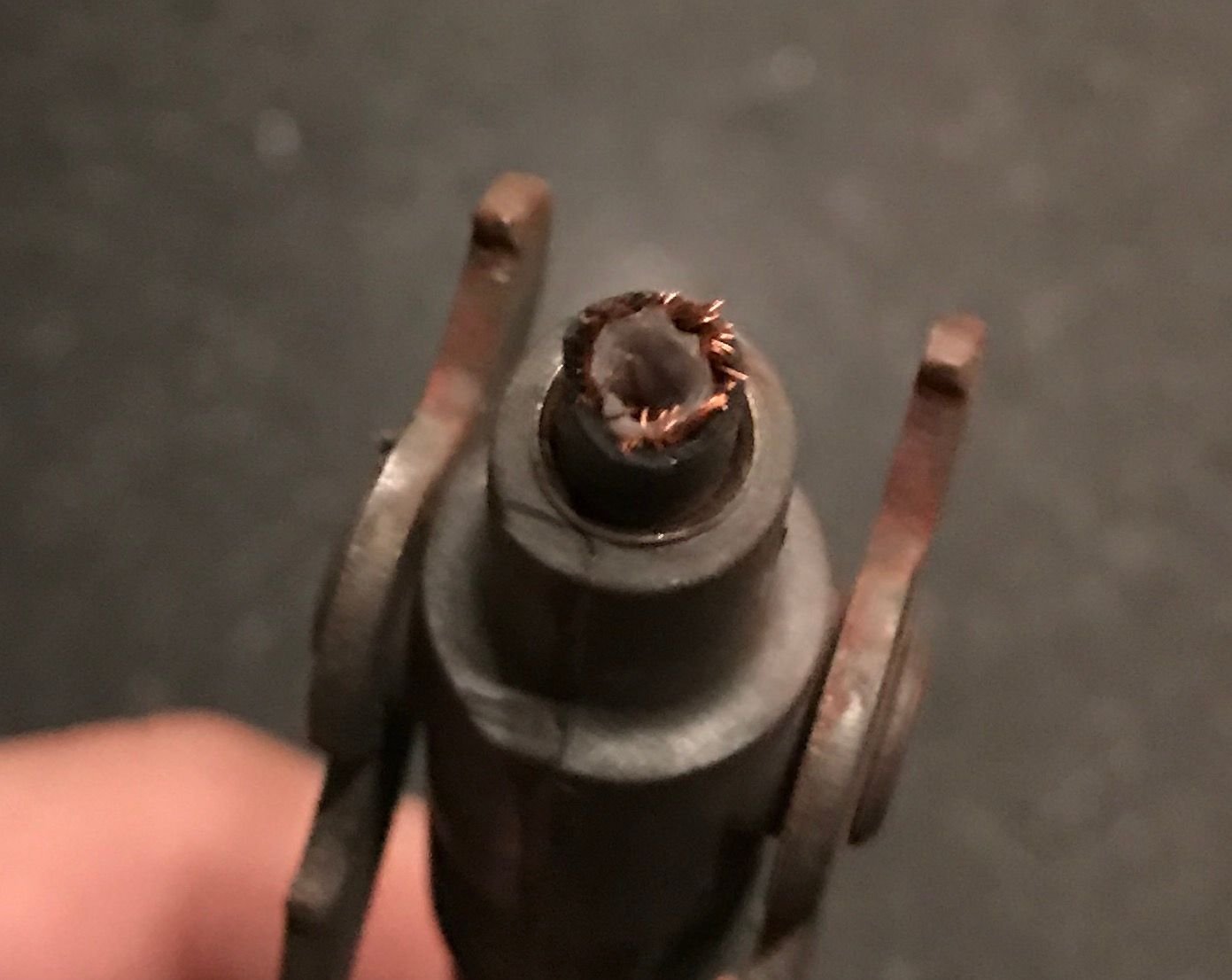

Today I removed the old non original antenna from my 66 and it all went pretty well until I had the antenna loose and under the car, I then noticed that the antenna cable that was used doesn't have a screw on type connector but is literally attachted to the antenna and isn't detachable.
I was planning to reuse the antenna cable because the original one isn't there anymore. So if I can't reuse this cable that would be a huge pain in the a$$. So I decided to cut of the old antenna from the cable and install a connector on the existing cable. The problem now is that I don't know which connector to buy that will fit the repro screw on type.
Cable I have, just standard antenna cable but a pic couldn't hurt
(don't mind the old antenna attached to it)
Connector on repro antenna

Take your antennae with you to an electronic store over there where you live and find one that fits...or unscrew that part off and take it with you...

Ask the antenna supplier what type connector it is.

Looks like your antenna was made by Ward Products Corp:
http://www.usbizs.com/NJ/New_Brunswi..._Corp_7Fr.html
I would contact them.

I found this on the forum its a 5 year old thread...maybe you can contact them and they would have the 'other' end that will work for you....
Post #8
https://www.corvetteforum.com/forums...connector.html

Well, I looked at the pictures one of the other members posted and that was what I needed to move ahead. Once I knew how to assemble it I moved on to getting the cable in. I noticed the cable was longer than the fully extended mast, and I noted there is a spring loaded friction wheel that bites into the cable. That explained the teeth marks on the old cable. So I cut off the "J" end piece.. I simply raised that roller up to make room and shoved the new cable in, until I could get the mast bolted on again. I reassembled the gearing and switches, and sealed up the wires. . Finger crossed it'll work and I got this right. I'll function check it tomorrow night after work one thing was odd.. The new cable came with a felt washer and a rubber washer looking thing that goes between the drive unit and the bottom of the mast. I tried as many ways as possible to install it but there was no way it was going to go in. So I figured, the "J" hook was not correct so maybe that rubber part should not be on the cable either. I removed it and the mast was still pretty tight but I managed to get it bolted onto the drive unit.. If nothing else, Learning is occurring.. By the time I am finished I'll be Qualified. LOL I also bought a three wire plug so make installation easier. if anyone has any hints on how to re install those upper two top bolts on the mast, I am all ears. Been thinking of maybe taping the bolts into the socket to prevent it falling out long enough to get the bolt started. I took it our via the tail light hole and a very long extension.
