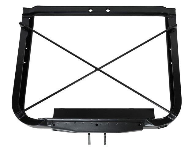

Pushers do not work as good as pullers. They obstruct the free flow of air getting to the radiator and the actual cfm through the core will be higher with a puller. You will not be able to attached the fans to the radiator with the X braces in front unless you cut them off and you cannot slide the unit down into the support with the horizontal brace. You would have to cut the X braces out and add the fans to the radiator AFTER installing it and that would mean "pinning" it to the core, which will void the warranty. So, I'd change the order and go with what works.

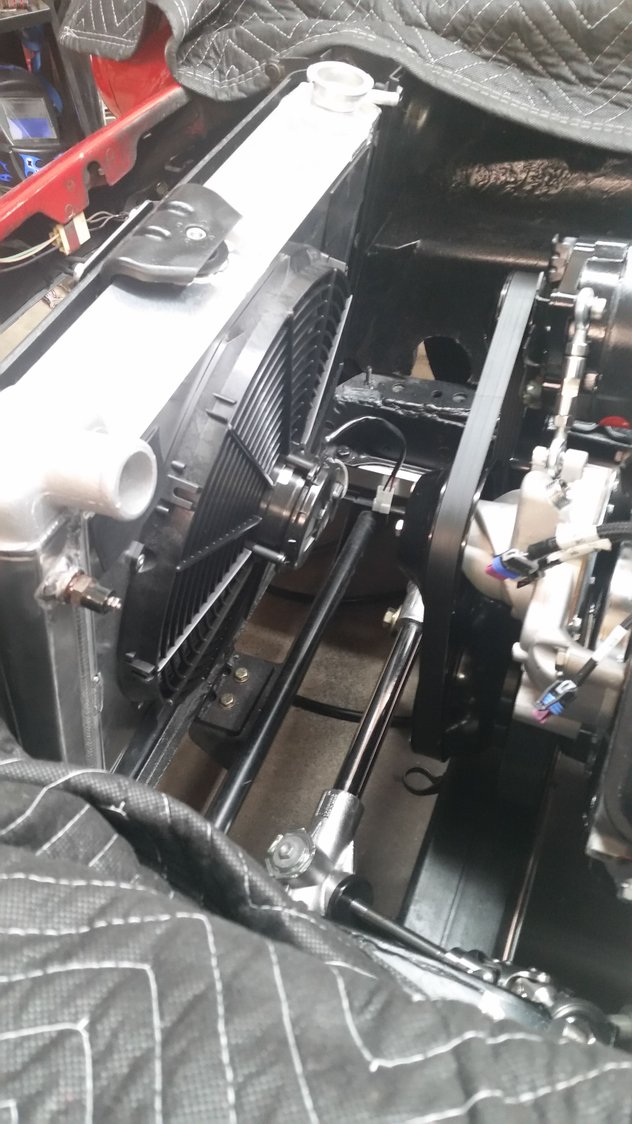

Old Jul 12, 2017 | 07:14 PM
copter98's Avatar
copter98
Joined: Mar 2015
Posts: 129
Likes: 12
From: Silver Spring Maryland
After around 6 months I finally opened the box and installed my DeWitts Radiator yesterday, Very nice! Thanks!
