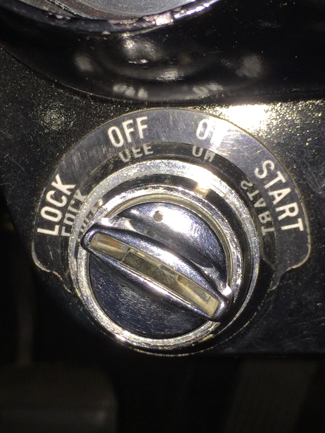

Close up
Dash
I just had mine out on my 61. Agree with above poster about tightening I'll try to post a good pic so you can see if there is a visible difference
