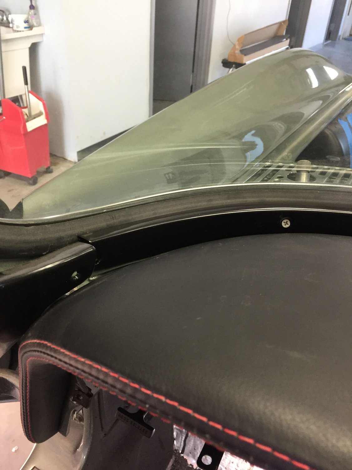

hello, putting my interior trim in my 66 coupe, does the Lower windshield dash trim overlap the upper sill or vise versa? Thanks Tom

Mine is out of my '66 coupe right now but "witness marks" on the parts show that the A-pillar moldings go on after the lower windshield/dash molding.
Ray

The lower trim is installed first and the A-pillar trim...
...overlaps the lower trim.
Thomas

thanks a ton, all this trim is going to be the death of me, but that sure helped
