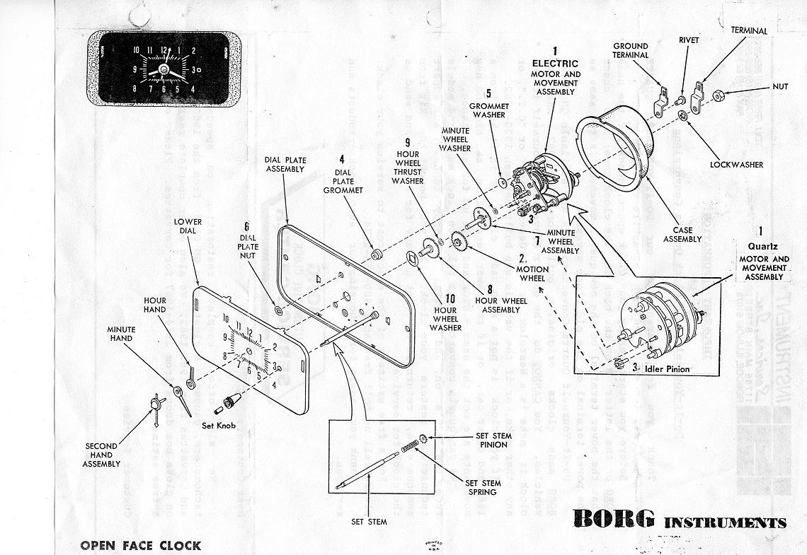

Instructions that came with mine (many years ago).
