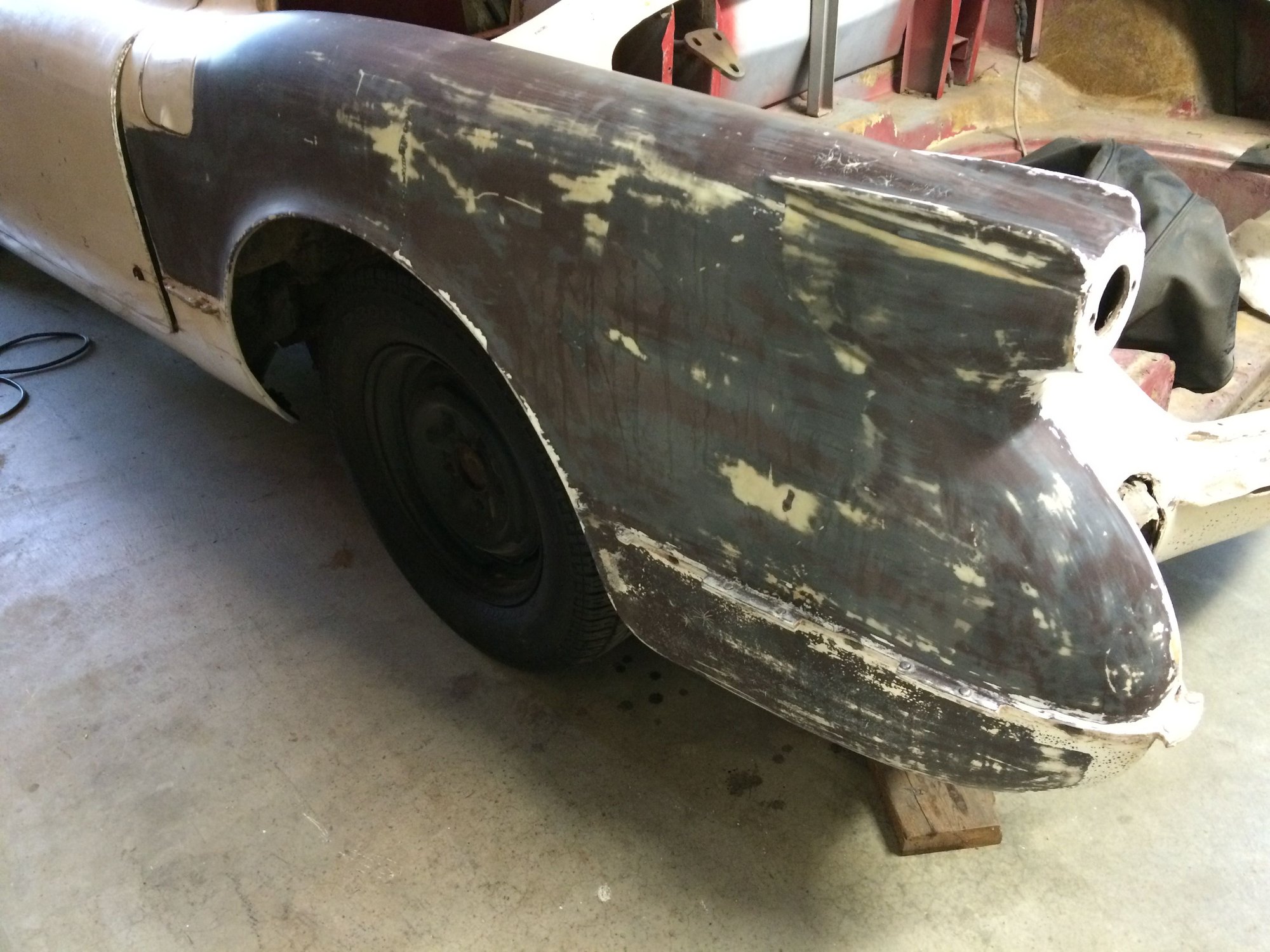

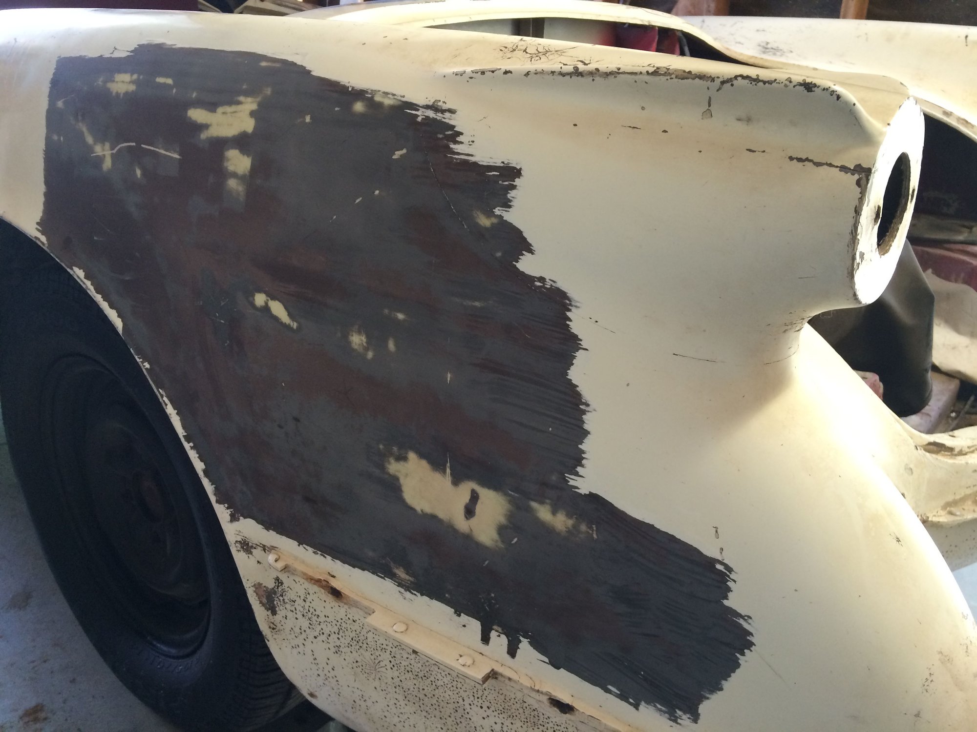

Brief update on progress. I know this isn't the body/paint forum but I'll post this here for continuity. I tried stripping with Citristrip and was pleasantly surprised at how effective it was. Perhaps a function of the warm weather here in southern CA as well as the very old paint on my car. Curiously, I see a layer of black under the white, and above what I'm assuming is the factory gray-brown primer. Interesting to speculate if this was originally a black car.

That is primer.

with Chris, your car was not Black originally it was Polo White. That is a primer you are seeing.

Thanks guys. Wasn't sure because there are definitely two distinct layers under the white. It may not show well in the pics but the uppermost looks black to me.
Anyhow, what's the consensus on removing the primer? Do most strip down to bare glass?

Todd - I strip every one to bare glass - you want to get down to bare - it will also show you any cracks, or repairs or any unstable areas in the glass that you might want to address.
