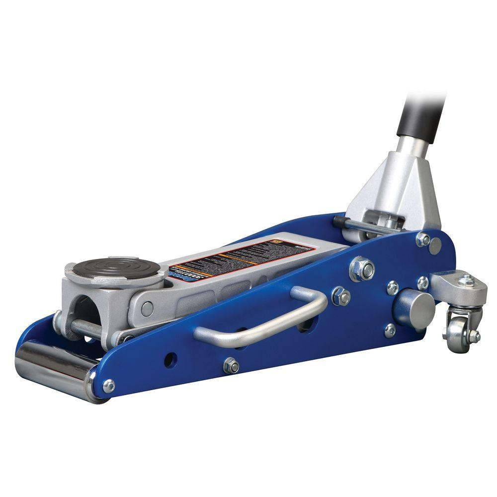

I have a 1.5 ton aluminum floor jack. I put this down in the rear passenger footwell of my Jeep whenever I tow our open trailer. It's basically the same size as a couple of boards if you thought driving up on boards would be the way to go. Myself, I like having better options. It has a two piece handle that comes off the jack and breaks down to less than three feet as well. Wrap them in a towel and they don't rattle.
I posted the Harbor Freight video that gives you a sense of the size, but the Home Depot brand is better at $109.
Video here:
Home Depot version.
http://www.homedepot.com/p/Big-Red-1...B&gclsrc=aw.ds

Ordered one of the drive-up jacks last night, but have a smaller floor jack with adequate lift that may be delegated for trailer use only. Good to have options for different scenarios.

Here is one thing to consider......
I have two floor jacks similar to the 1.5 ton jack shown.
They work great for jacking up my 3000 lb. Corvette.
When I tried to change a tire on my heavy camping trailer.........Nothing!
The jack didn't have enough capacity to lift the weight even one inch.
Make sure it will do the job, before you are stuck on the side of the Interstate.
