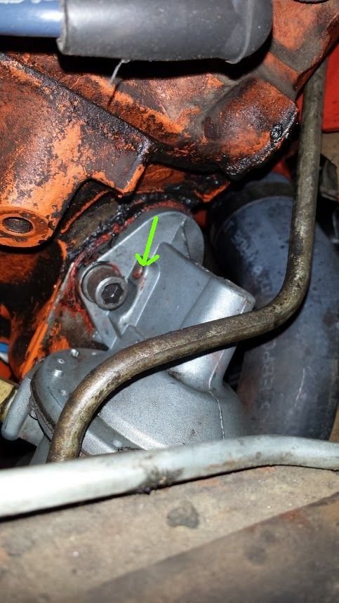

If you have spark, you most likely have a fuel problem. An issue I have seen more than once is the pivot pin works out on the fuel pump and you get intermittent fuel supply. One of the guys in our club has a 65 that would die or miss badly after a little driving and then would not start (starter would engage). After extensive troubleshooting, he found that the pin was missing from the fuel pump arm. The car would run for a while, start to miss, then die. It would not start until it sat for 10-20 minutes and then start again and run for another indeterminate distance, sometimes miles. I'll attach a picture of the pin I'm talking about. One of the members here on the forum made a bracket to span both sides of the pin to prevent it because he also had the problem. You can search "corvette forum fuel pump pin" or "is this my fuel pump pin corvette forum" and read about all the people who have had this and why. It's an airtex pump design issue that allows the pin to work it's way out.
First thing, determine if it's fuel or spark causing your problem.
Here's the picture and a pdf of a fix explaining the issue if it's the fuel pump:
Slipped pin and broken fuel pump arm spring.pdf

The fuel pump pivot pin is in place. The red power wire checks good all the way to the cigarette lighter. The bulkhead connectors looked very good. Cap, rotor, and points looked OK. I got a new condenser, but tried running with the old one first, as a base line- the car barely started, and ran really rough. I put in the new one and it started right up and ran smoothly. I will stay in my area and run it for a good time tomorrow.

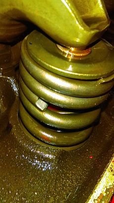

I had these symptoms last summer, suddenly. After two weeks of tune up, timing and carb adjustments, fuel filter, changing plug wires, etc. I decided to pull the valve covers. There it was. A broken valve spring, after 50 years and 90,000 miles one finally went. While I was in there I adjusted others that made a big difference.
'66 427 broken exhaust valve spring
