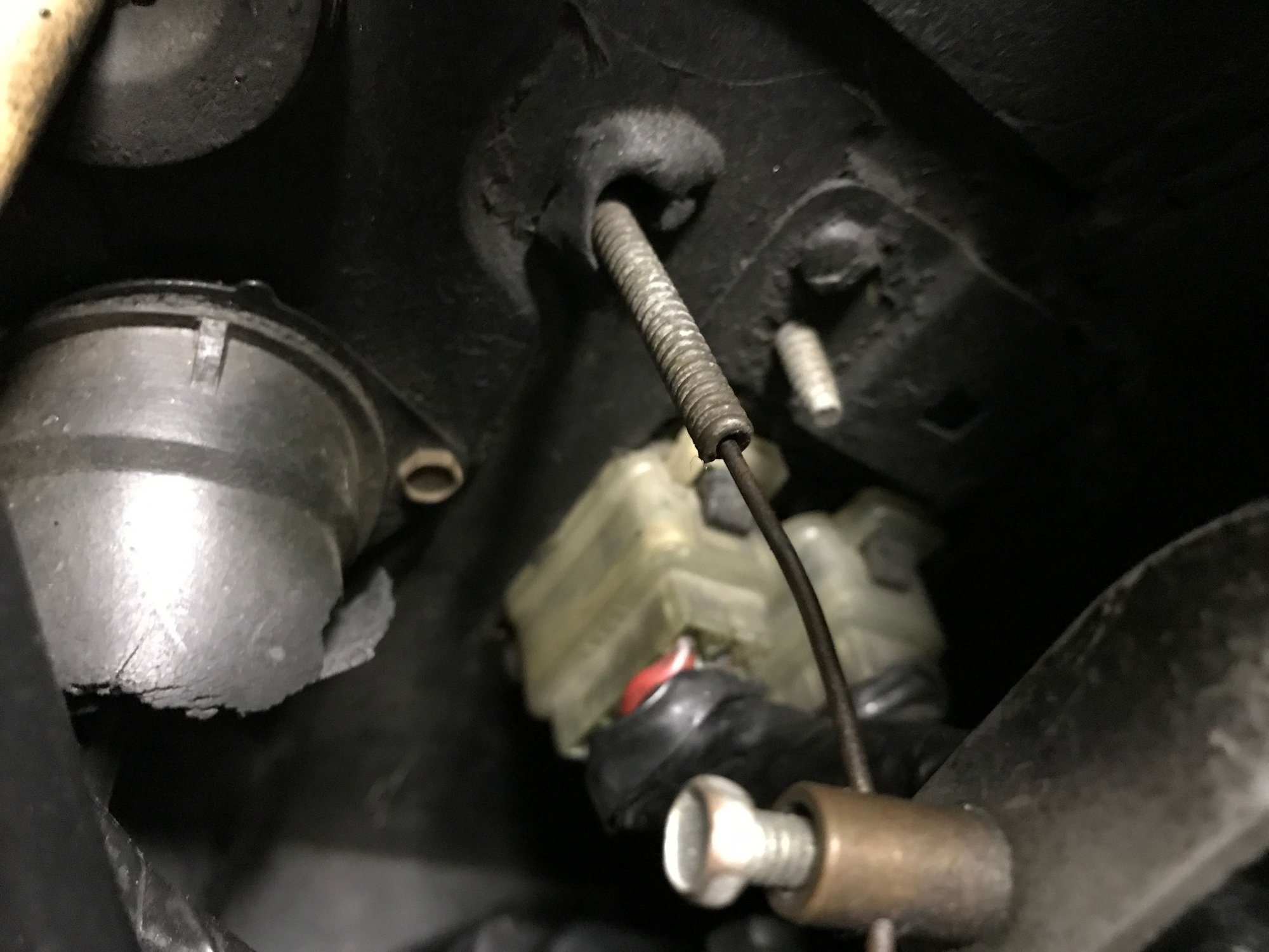

I looked at the firewall in the engine compartment to see where the wiring passed through. I found 2 white plastic (aged) electrical plugs just to the out side of where the clutch pedal rod comes through the firewall. The plug to the inside had a red wire so I thought that must be the feed to the fuse block. I grasped ahold of it and I heard an electrical-mechanical sound like a relay. Everything started working again!!! This area must have a ground potential. I will open the battery disconnect and look this connection over carefully to see if I can find the issue. First I gotta sleep a little - worked all night shutting down the Lauderdale Power Plant as it cycled off. I'm so happy the baby is alright.
electrical connections through firewall
1964 L76 engine

Those are the bulkhead connectors; you should examine them carefully for corrosion, bent/scorched/missing/pushed-in pins and general condition. A good spray out with DeOxit contact cleaner spray or the like is advisable...
I suspect the sparking at the cigarette lighter was a symptom and as you've discovered your problem it seems...

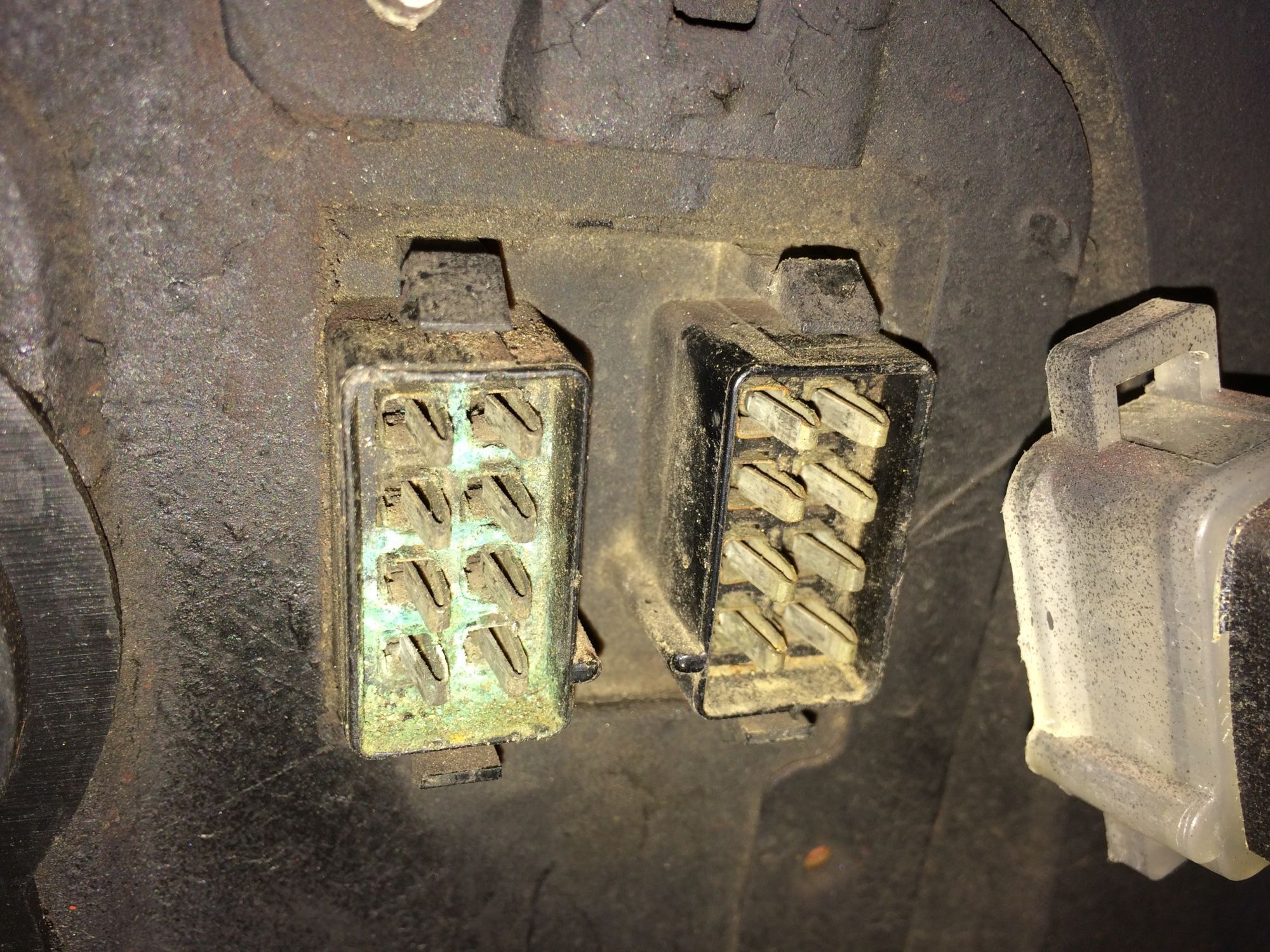

That's the red wire. It connects to the back side of the fuse box. Clean those contacts at the bulkhead, and don't plug the charger anywhere except the battery. Here's what a really bad one looks like:
Wow, those are really corroded, mine were starting to go bad. Just gave them a thorough cleaning based on recommendations. Thanks for the help.

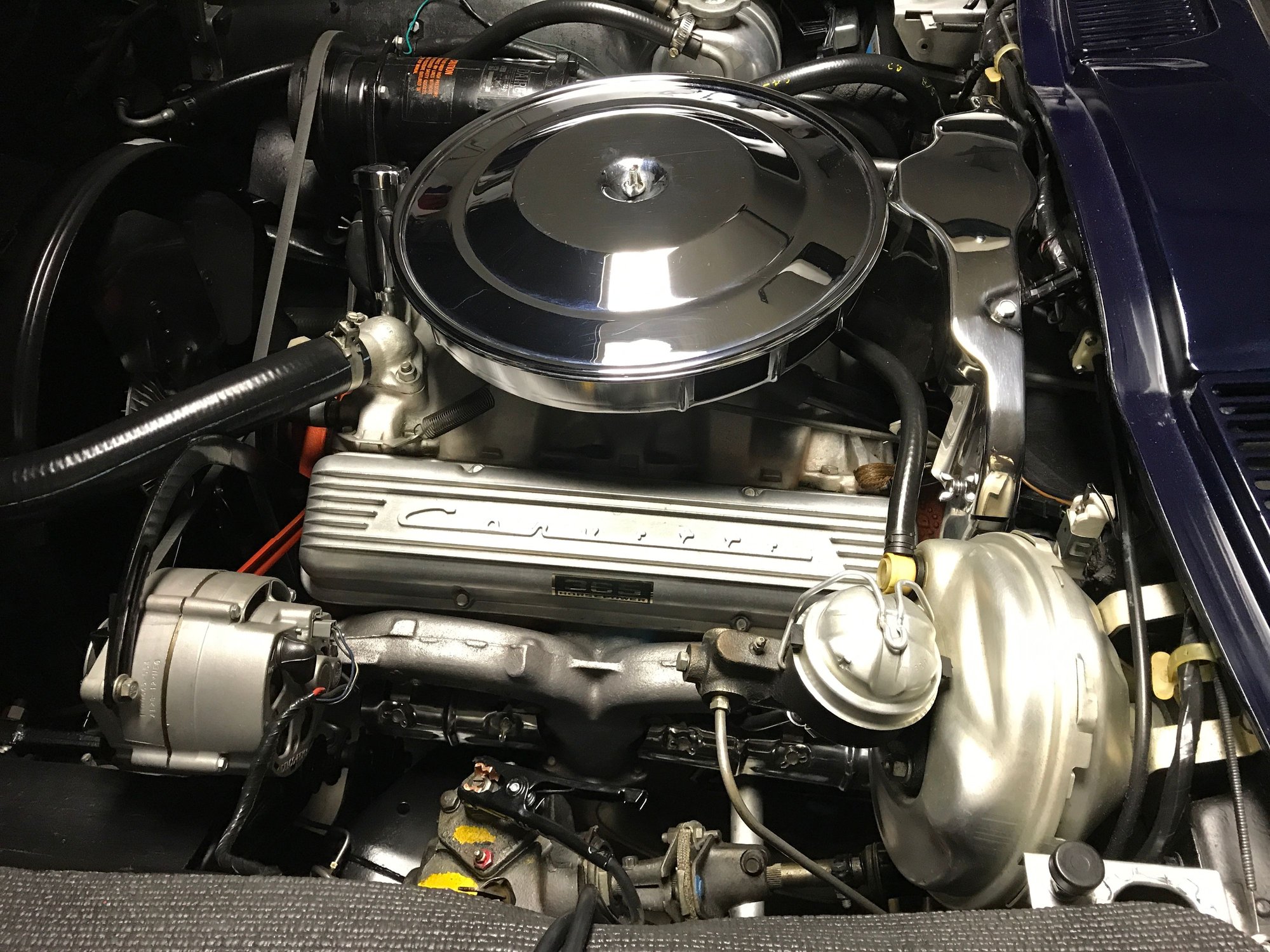

Smear some dilectric grease on those terminals before you snap the harness back on...it will help keep the corrosion demons at bay
P.S. Check the length of your alternator belt. Your adjustment is at the max edge...shouldn't have to be that far out...maybe a belt an inch shorter. Very sanitary engine compartment. You should be plenty proud.
Good eyes...
Indeed, a squeaky clean engine bay...and we know how much work that takes; I always enjoy seeing those slightly yellowed, original plastic wiring harness straps in front of the cowl.

Thanks guys, it keeps me busy, keeping it up, it's very original, even the corrosion! I will look for an alternator belt. The alternator housing is original, guts rebuilt, they spoke of it in Nolan Adams book. Just recharged cooling system, it really blows ice cold with the R12 but boy does that compressor pull some horsepower to spin it. My car was built 7/21/64 last day of 64' production. VIN 122152
