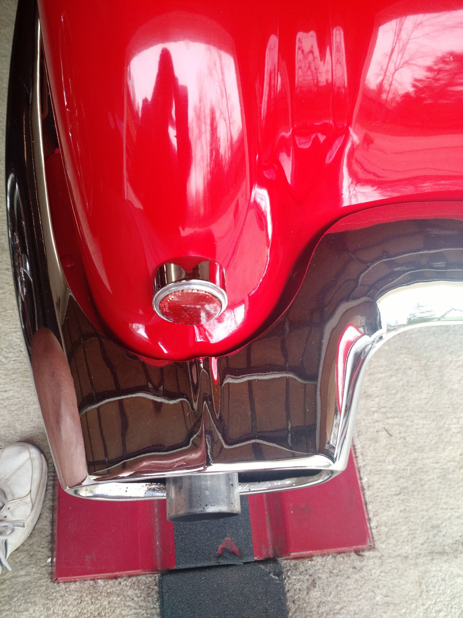

I have a 1960 and I know many C1 owners let the tailpipe extend a half inch or so beyond the bumper, I assume to reduce carbon or condensate deposits inside the bumper. For those who have done this, or thought about doing this, how do you view the pluses and minuses relative to ending the pipe inside the bumper as original? I need to make a decision for mine soon. Thanks.

I went to the auto store many years ago and bought two tail pipe couplings (?) and added them to the tail pipe on my 59. Extends about 1.5 inches past the bumper. Keeps that area MUCH cleaner. The only down side is that I occasionally bang into them with my legs.

I posted this information on another thread seeking advice on exhaust systems and muffler choices. I have a semi custom stainless exhaust installed in my 60 many years ago (over 25 years) that the installer suggested he extend the tips about 1/2" to 3/4" beyond the chrome bumper exits, not so much to help keep the bumpers cleaner, but because my exhaust will actually grow 1" to an 1 1/2" as it warms up. It was explained to me and I had to agree that as the system expands in length, if he were to cut the pipe ends short to keep them hidden inside the bumper exits, I would run the risk of the ends catching on the inner lip of the bumpers and literally pushing them out and causing damage.
I have had my system installed all these years and never had an issue. You can hear the exhaust pipes shrinking as the system cools.

Hey Bill, I much prefer them to stick out to allow exhaust and moisture to blow outside the bumper. My exhaust guy ignored me and ended them inside the bumper, so I had him make a couple of short extensions by tapering down the end of the same size pipe. I tap it up inside the pipe and can remove it if I need to if it should get nasty looking.

One of my 57's had a Zierden stainless exhaust system on it, and I'll call BS on the expansion claims too. My neighbor had a '58 at the time with a new aluminized steel system - his tailpipe protrusion gained about 1/4" to 3/8" when hot, and my stainless system grew EXACTLY the same amount. Look in the tables in your Engineer's Handbook and compare the coefficient of thermal expansion between stainless and aluminized steel tubing, and the difference is insignificant.
