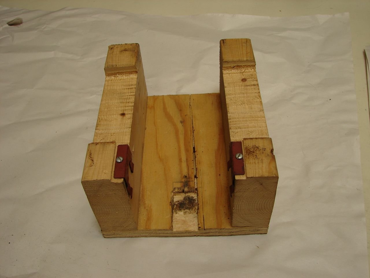

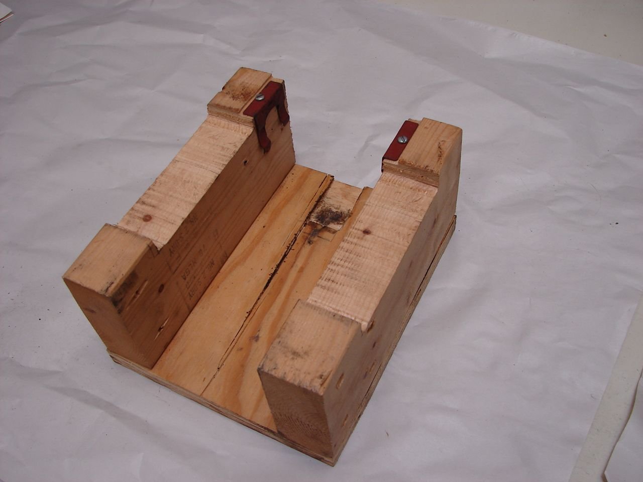

It can be picked up in the rear by a jack centered under the differential. But do not try using a jack at the 3rd arm (steering) support bracket in the front. It has been known to crack, when being jacked up. If you want to lift by a jack in the center of the front suspension, then make a fixture to support the vehicle on either side of that bracket.
Something like this:
I have drawings with dimensions, if needed.....
