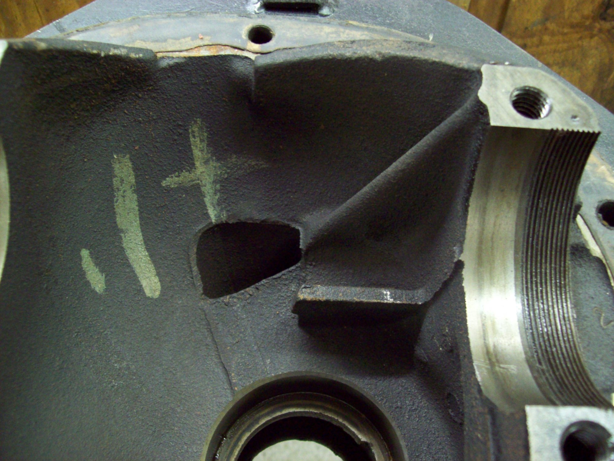

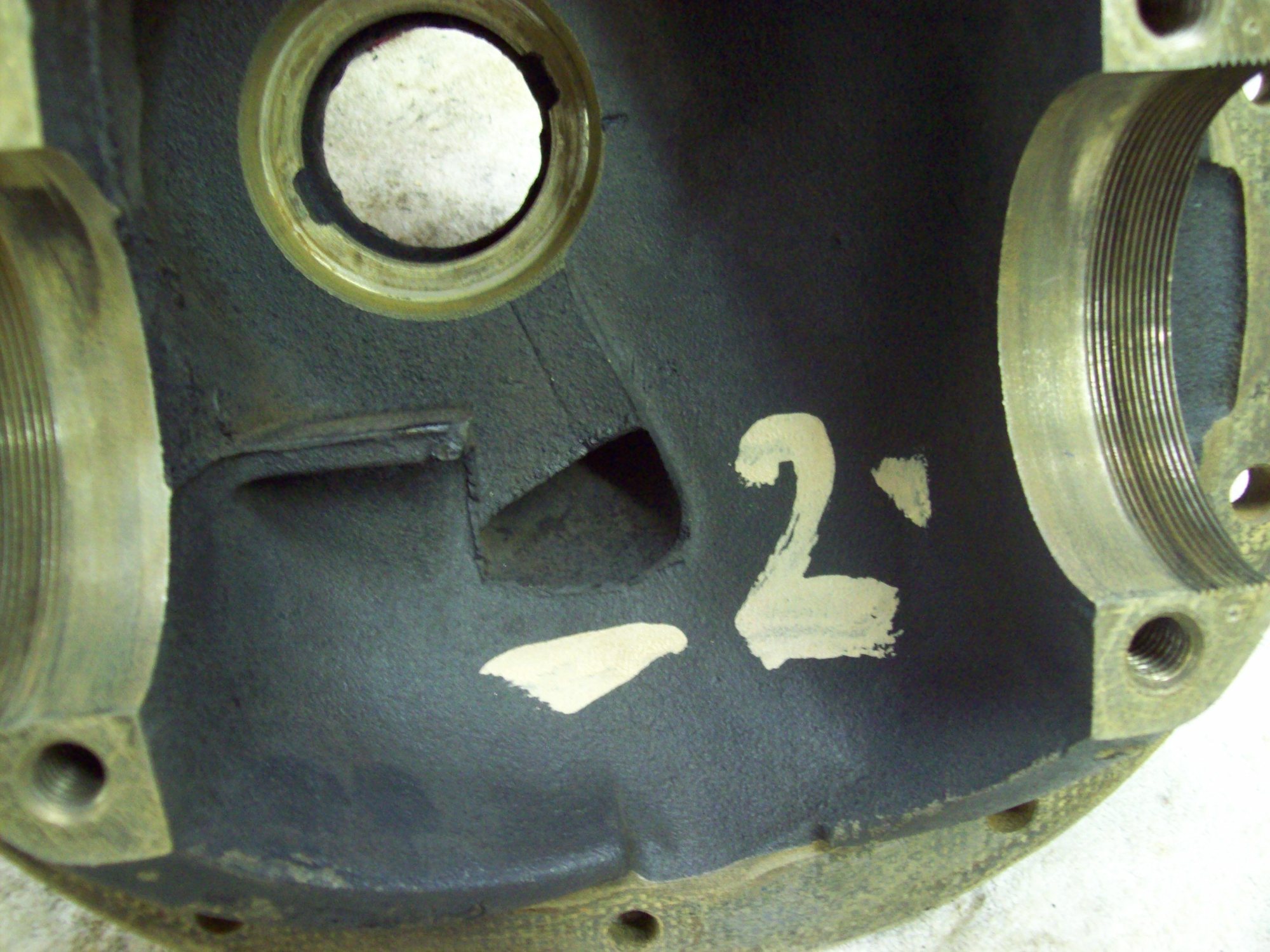

The 57-64 NON-posi case has a gusset inside which has to be partially removed so that a posi unit can be installed inside a NON-posi case. I did an article a few years ago demonstrating how to do this-------------BUUUUUUUUUUUUT, Photobucket has hijacked everyone's pictures which have been posted and they want a ransom ($400/yr) to allow 3rd party posting of pictures. Thus, the pictures no longer appear on my article!!! If you are interested, I can email you a PDF version of the article.
Below are 2 pictures of a before and after removal of the gusset that I mentioned.

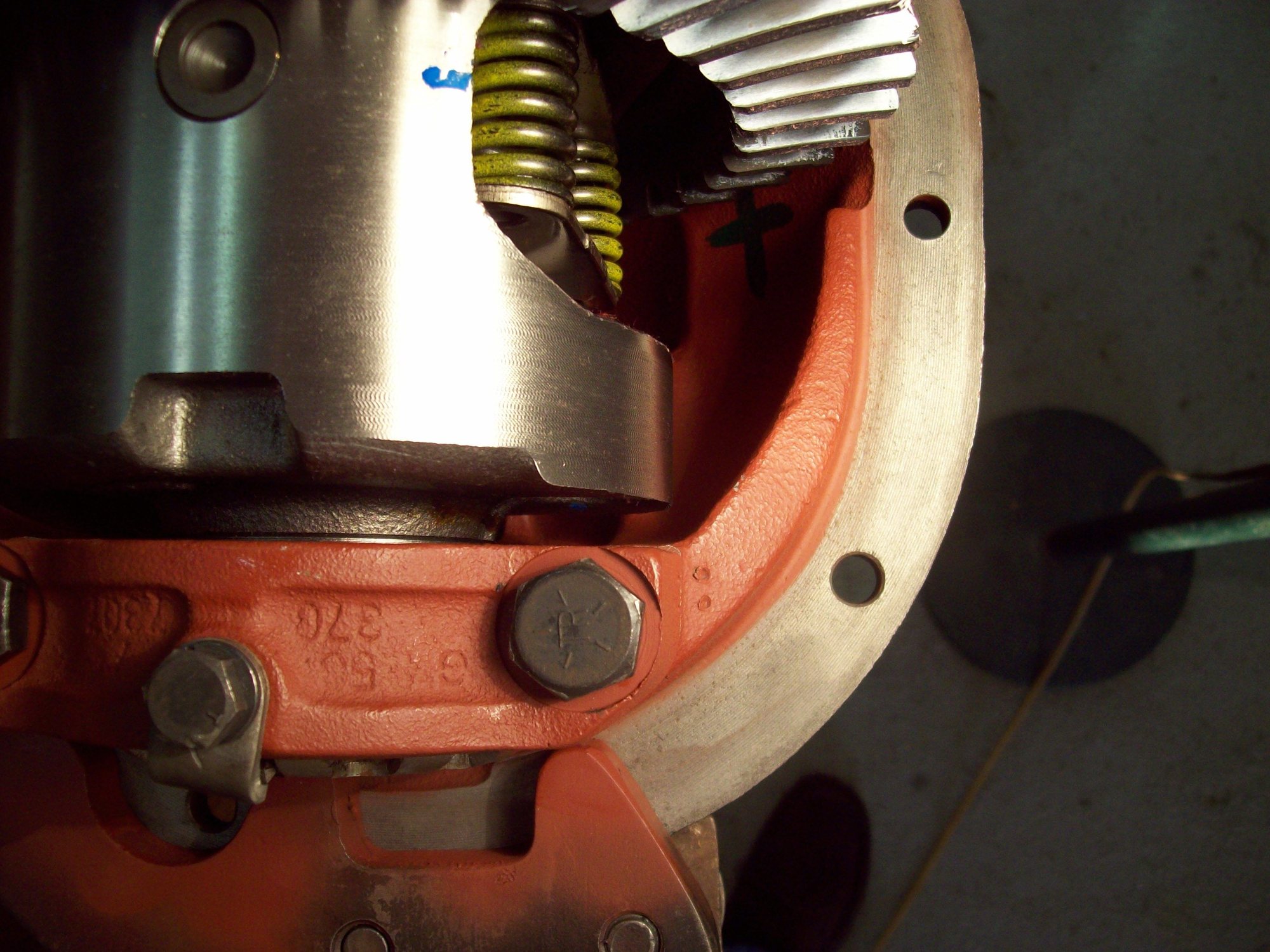

That gusset is NOT, repeat, NOT in a posi case, as seen below.
This picture shows very clearly why a portion of the gusset in the NON-posi case has to be removed, because the posi unit fits VERY CLOSE to the wall of the case.

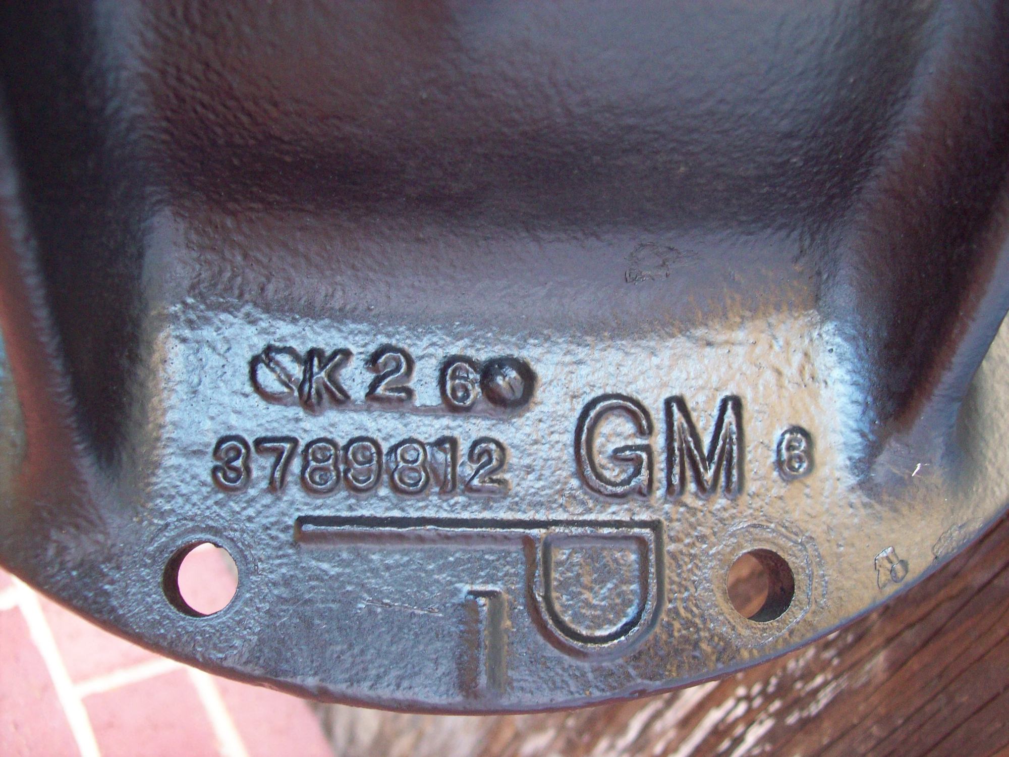

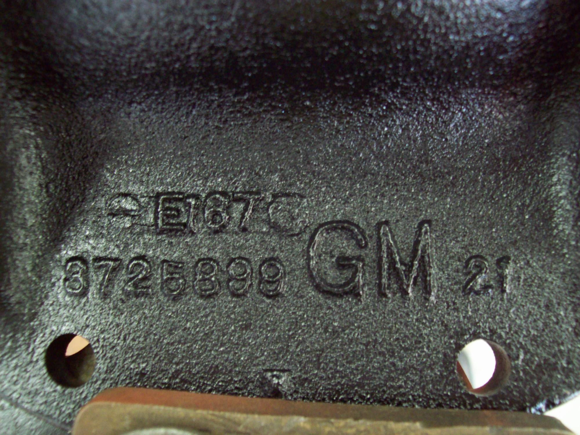

It's your car, it's your money, you can do as you wish. The 812 was a posi case (all posi cases have the big P cast next to the casting number).
Posi was still an option in 62. The casting number on a NON-posi case was 3725899, and was used on pass cars through 64. If you could locate a 1962 899 rear from a pass car (should be pretty cheap), IN GOOD CONDITION, that would be a good start for cheap. MOST 62 pass car rears were either 3.36 or 3.08. If you wanted to go posi, then you could install an Eaton or Nitro posi unit.
Here is an 899 (non-posi) case and an 812 posi case (with the big P).
