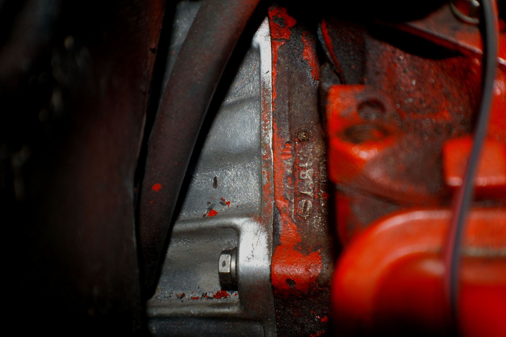

So, I found the block date code but as you can see from the pictures it is useless. I can't decipher any of the letters or numbers in it. I guess I am just going to have to be happy with knowing it's a 1962 to 1967 327 GM engine and that's it.

Well, that sux. You're right, that doesn't help much.
I'm going to go out on a limb here and say that the last digit might look like a smashed "7", as in 1967.
If you're pretty sure (not sure how) that the engine is not original to the car, and the casting date is buggered up, and you have nothing to lose you might try carefully to grind/file off the casting date to get to undamaged original casting numbers. Maybe.
The other thing is - if the engine is reasonably intact as it was originally assembled, instead of an agglomeration of mismatched parts, the accessory part casting dates may yield clues. Just a stray thought. For example, if the intake manifold, exhaust manifold, water pump, and etc., have reasonably matching dates, it might support a reasonable conclusion as to its origin.

It's pretty buggered up for sure. As a last resort, if you can get in there, take a white grease pencil and light go over the top of the cast. Sometimes it will allow you to see what you want to see (the numbers) and not all of the other garbage around it. It does look like a 7 at the end. Try it. You might be surprised what you can make out. Good luck.

Can't be a 7 since 870's were last cast in 65.

Information I found says 870 were made 1962 to 1967.
