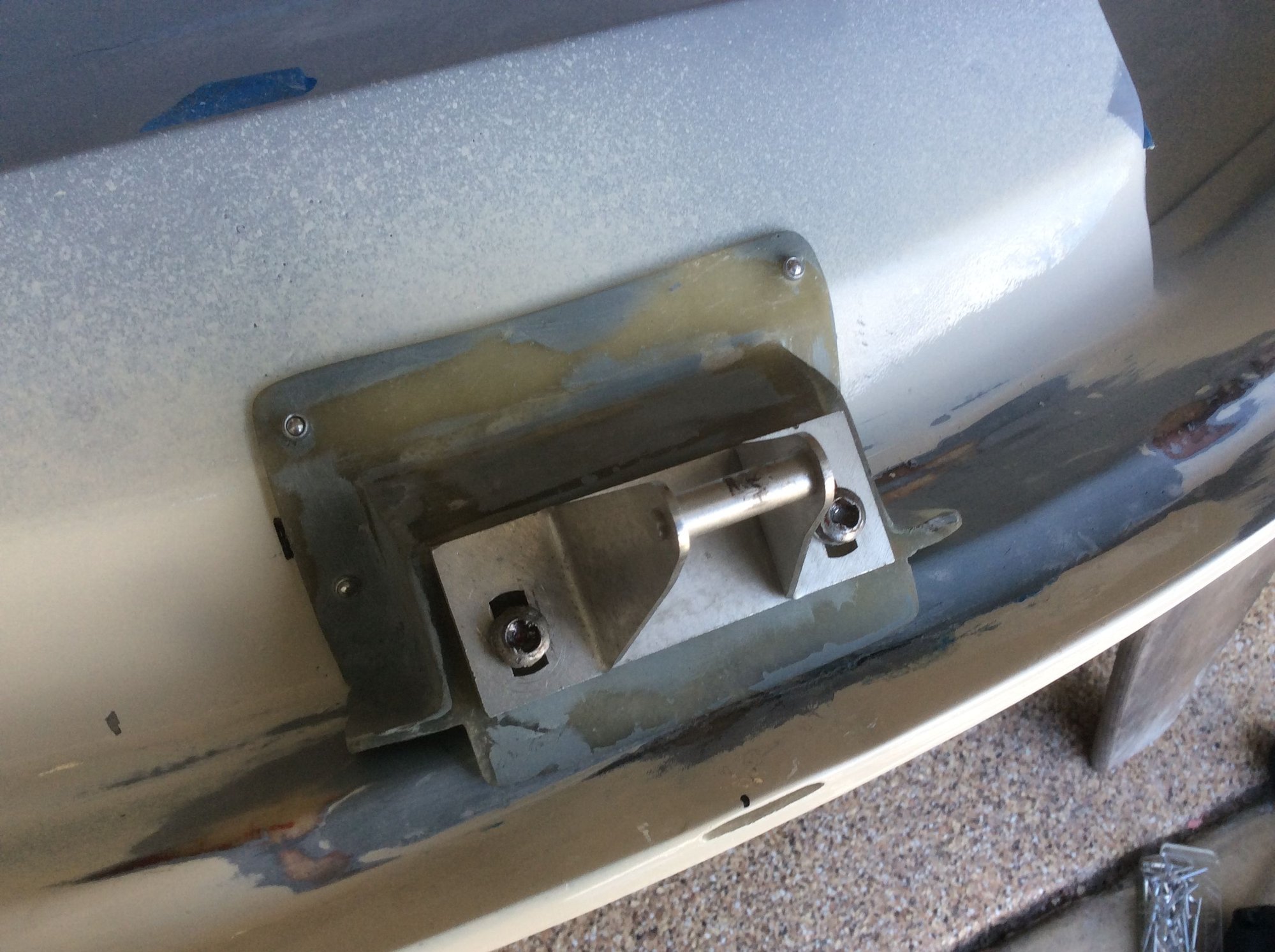

That's what I did. Ordered a latch support from Brett then riveted it in place. There is a metal back plate with threaded holes that allow you to attach the latch to the support. Turned out great.

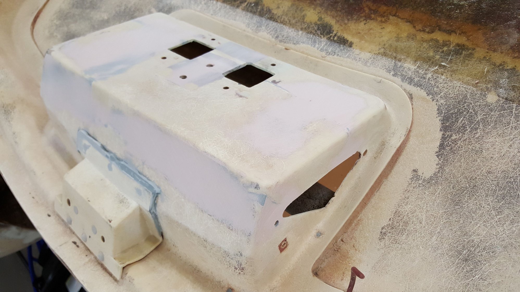

Here is one I installed on an early 54 #68
