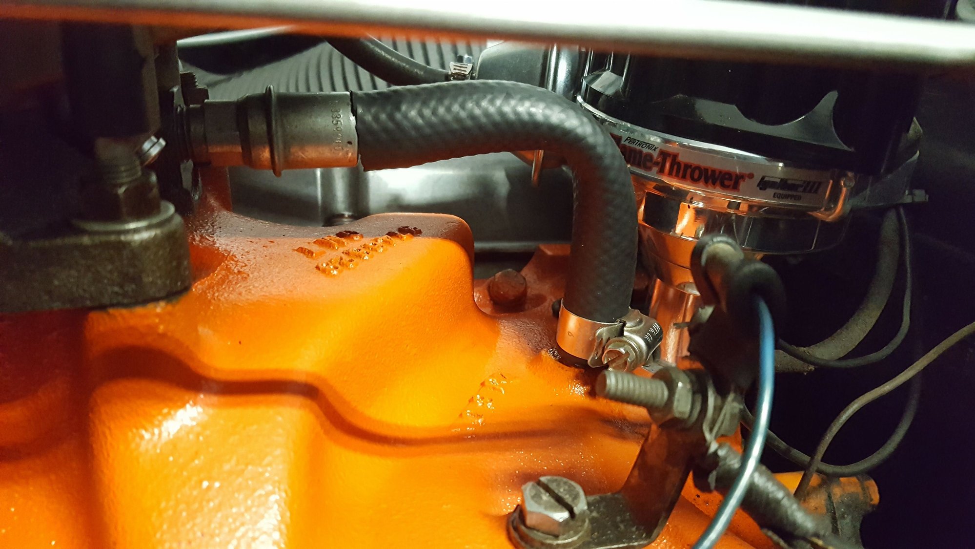

I know there has been a lot said about the C1 PCV valve options in this forum, but I have a different question. Long story short, I have a 1962 with a 1969 350 CI engine. The valve covers were replaced with the finned corvette valve covers with no intake / exit holes for PCV. There is no place to install the PCV behind the distributor since that was not needed in 1969. I want to keep the original appearance of the valve covers and was looking for options on the internet. I came across this picture, but have not seen this arrangment suggested anywhere else. This would work for my engine since this appears to have the same port for the PCV and the same Eldebrock 1406 carb. I am appealing to the experts. After looking at the picture, does this work or solve my problem? I have a vented oil filler cap and a port off the oil filler tube where I have my PCV valve now.

I think it will work OK but be aware there is no oil baffle under the valve so it can sucks oil vapor and possibly cause problems with dirty spark plugs.
Why not install a set of later corvette valve covers with the baffle and use one valve cover for the pcv and the other for the breather.
That is what I would suggest but it seems some have success with a system as shown in the photo.

I have a 1970 350 (LT-1) shortblock in my 61. I also run the stock finned covers.
The PO (my dad) drilled the intake and created a PCV system just like shown above, except it uses a PCV valve (I would think that is need above??? I would think a back-fire would be VERY BAD!)
Inside the intake, he "rigged" a simple oil separator (a copper tube with holes drilled in it). It works well.. The only issue is that is does ingest a little oil at 'max vacuum' (deceleration with throttle closed). I can smell it when it happens. But it only uses about 1/2 Q in 3000 miles.
Also, I don't have ignition shielding... but I don't think it would fit with this setup.
Fred
The PO (my dad) drilled the intake and created a PCV system just like shown above, except it uses a PCV value (I would think that is need above??? I would think a back-fire would be VERY BAD!)
Fred
I think they installed a grommet and placed a PCV valve in to prevent backfire from carb to intake manifold. Can it backfire in the opposite direction also? Not sure how things look underneath. Thanks again for your reply.

[QUOTE=ukcraig;1595632921]I think they installed a grommet and placed a PCV valve in to prevent backfire from carb to intake manifold. Can it backfire in the opposite direction also? Not sure how things look underneath. Thanks again.
So what's underneath this bolt

[QUOTE=ukcraig;1595633483]
That bolt/plug goes to the intake runner and is an auxiliary vacuum source for say, a power brake booster.
That's on an intake runner, so it's manifold vacuum. You need a spot that accesses the "valley below". I had some pictures of baffles others had made for using the PCV there. I'll see if I can find them.
