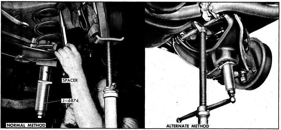

Take the shock out. Put a chain around the coil to contain the spring and knock the lower ball joint loose from the control arm while it's supported by a floor jack. Lower the jack and the coil should come out peaceably.
To install the longer, softer spring, just reverse the procedure. I believe the last time I did this, I loosened the control arm bolts at the frame to get a better angle to push the longer spring in place.
No special tools required but compressors are available.

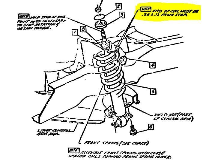

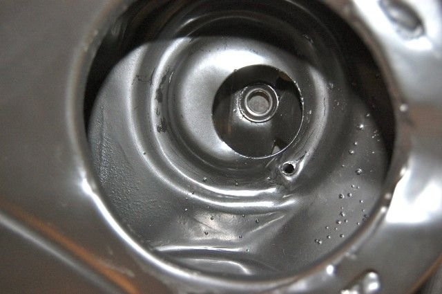

Make sure the lower end of the coil sits in the little pocket with the drain hole. Dennis

I prefer the "alternate" method. Much easier.
Also, according to the '66 AIM, the spring is indexed to the pocket in the frame.
