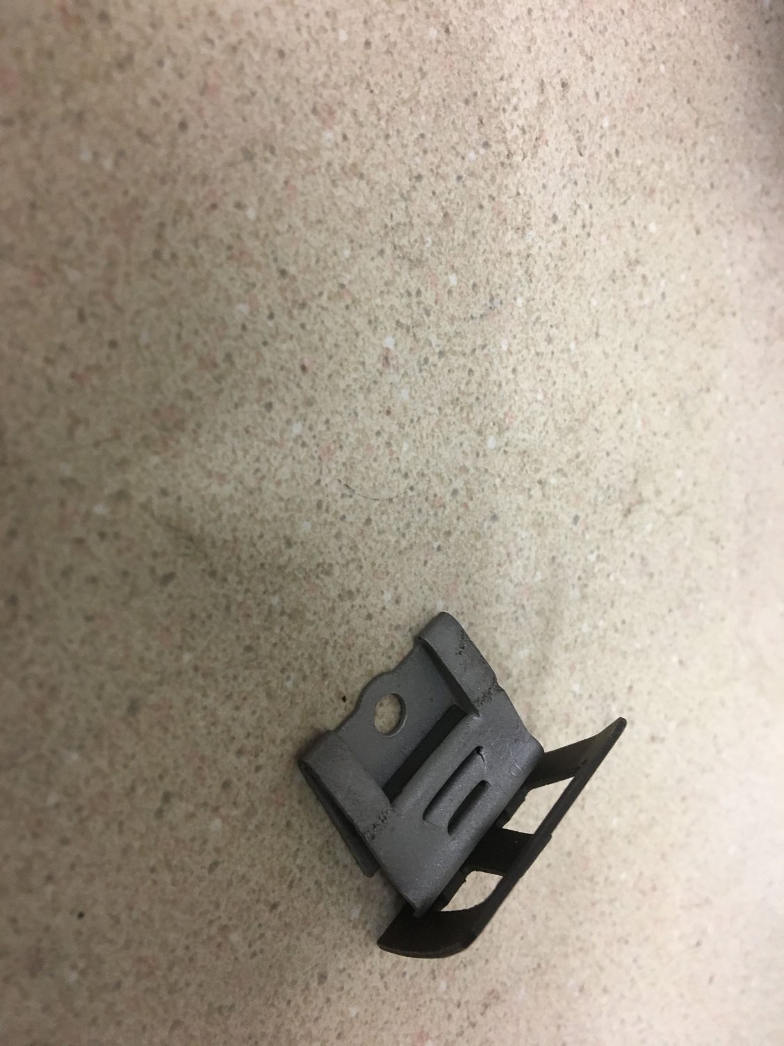

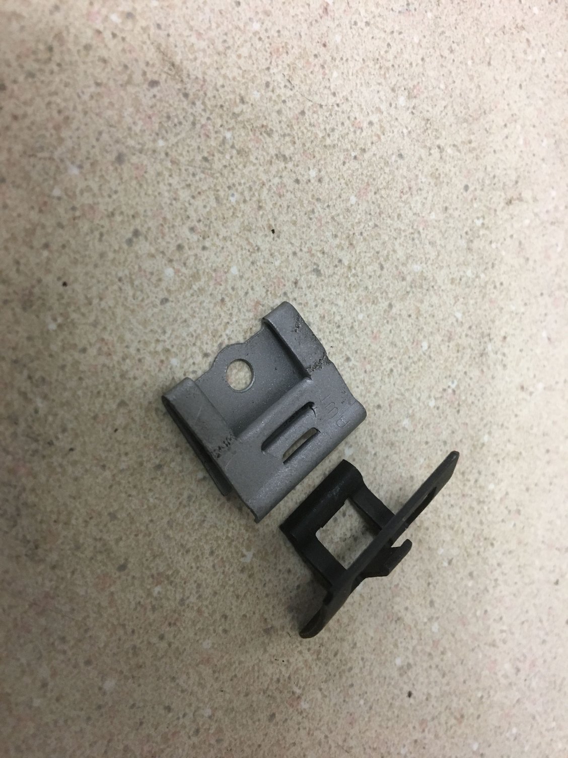

hey guys, I am laying out my roadsters trim clips for my windshield.it looks like it calls for a special clip at the bottom ends by the posts? I cannot figure out how these work can someone give me a install pic? here are the clips.
the 2 singles are the odds ones I cant figure out. its been so long since I took this thing apart! let me know your thoughts here! thanks troy

The clips on the body are all the same. The clips that are located at the bottom corners are attached to the outside stainless molding, and then clipped into the lower windshield clip. I've attached a couple of pictures. Hope this helps. All of the vendors sell the trim clips.

thank you mike! that's what I needed too see. so just the outside corners get those second clips? troy

Yes. There is one one each side.
