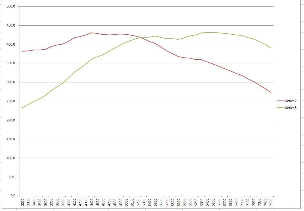

This is not an exact answer for you but I hope that it's close enough to offer some help. I have been running a XR286R with 1.6 rockers in a 327 for 5 years now. Probably about 8000 miles mixed driving. Not much stop-and-go, but mostly town-and-country/highway cruising. Your TKO with wide ratios will make it very easy to drive. I can tell you that mine is with a 3.70 like yours and a RS600 with 2.77 first gear. I check the lash about once a year, but it never needs adjustment, so far. The lifters use EDM holes for extra oiling which is a big plus. You should use a rev kit to keep the roller in constant contact with the lobe. These 2 precautions I believe will increase the life of the roller lifters. All of that being said, I think that a hydraulic roller is more suitable to your heads considering their lower lift............especially considering the limitations of the induction system, small heads, and your probable use of iron exhaust manifolds. In that situation, you can rest easy that the tappets will live for a very long time. You should easily see 300 RWHP with either of your HR choices.
Below is what you might want to see. Expect a flatter torque curve with a smaller cam, of course. My heads are 203cc, so expect a correspondingly lower but flatter torque curve with your build. I run 11.6:1 static with about 8.7 DCR and .035 quench. Good luck.
One more thing...............you should use a 1.5 rocker with your heads. The extra lift from the 1.6 will be basically wasted on yours. And you will also have to change your distributor drive gear to a melonized steel one. This cam is not compatible with the original, iron gear. Neither are the hydraulic rollers.

I disagree. The cams you are looking at have about 20 degrees less duration than mine has on both sides. I can easily shift into 5th at 45 MPH and pull away. I can easily cruise @ 2000 @60 although I usually cruise @ 2500 @ 80.
Ineresting to hear. Reviews that I could find on the 110325 indicated that it did pull well from idle, but cruised best in the mid 2000s
If I were you, I'd use a hydraulic roller of around 220 degrees duration on both sides with a wide LSA to cut down overlap because of your corked intake and exhaust. I'd install it advanced a couple degrees to give more DCR and I'd have no problem running .035 quench so long as you have non-stock connecting rods. With stock rods, I'd go no less than .040.
The car will likely have headers and 2.5” exhaust. I’ll likely be swapping out the 2x4s for a single on occasion too, especially if I take it too the track. My target duration is mid 220s @.050”, LSA 110. Exhaust maybe as high as 230.
You have to make up your mind whether you want to sacrifice torque for a "mean" sounding engine.
Looking for a balance between the two. Having good low end torque is great, but if it’s not combined with good top end hp, it’s just not as fun to drive. Car need’s to pull hard to 6000rpm. Needs to sound good too.
Hydraulic rollers are NOT subject to the same harshness of solid rollers so needle bearing scatter should not be a consideration. If you insist on a solid roller then using EDM oiling holes in the lifters and a rev kit will protect the lifters.
I have no concerns at all about hydraulic rollers, just the solids. If I do go solid roller, it will definitely have presssurized lifters and rev kit
The results I posted earlier are RWHP, in case you didn't notice. That's about 475 or so flywheel.
Too give you better insight on my driving style. I regularly drive a twin turbo diesel truck. It makes 964 RWHP (with no correction factor) and turns mid 10s with street tune and tires. Good spooling starts low 2000s and it has a 2800 stall converter. So I am use to keeping the rpms up to suit the build. Kinda enjoy the rpms.
If it weren’t for my wife driving the car some, I’d probably be looking at bigger cams. But with her driving it, it needs to have a balance between torque and hp.
