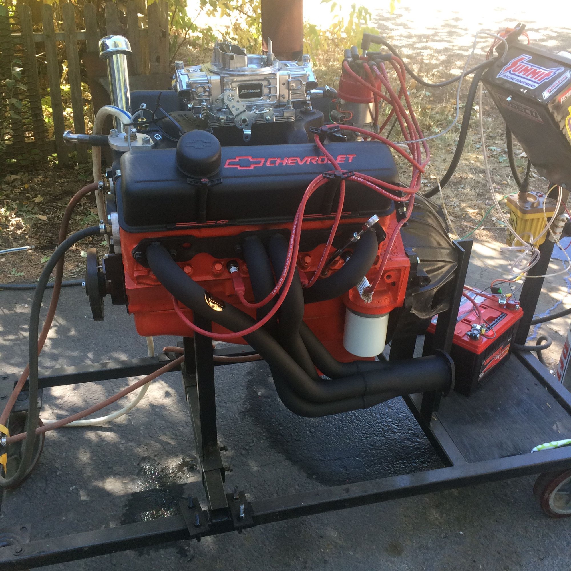

If you do use hookers and don't get the coated one you must sand off the paint that comes on them and repaint. Also you have to loosen the steering stop and move it out of the way on the drivers side. put mine in without a scratch. if you using a canister oil filter they mite not work. I'm using an adapter and shorty filter and its close.

H
ere's a pic of the filter clearance

Originally Posted by reno stallion
H
looks good reno! I want long tube, so those would work..
