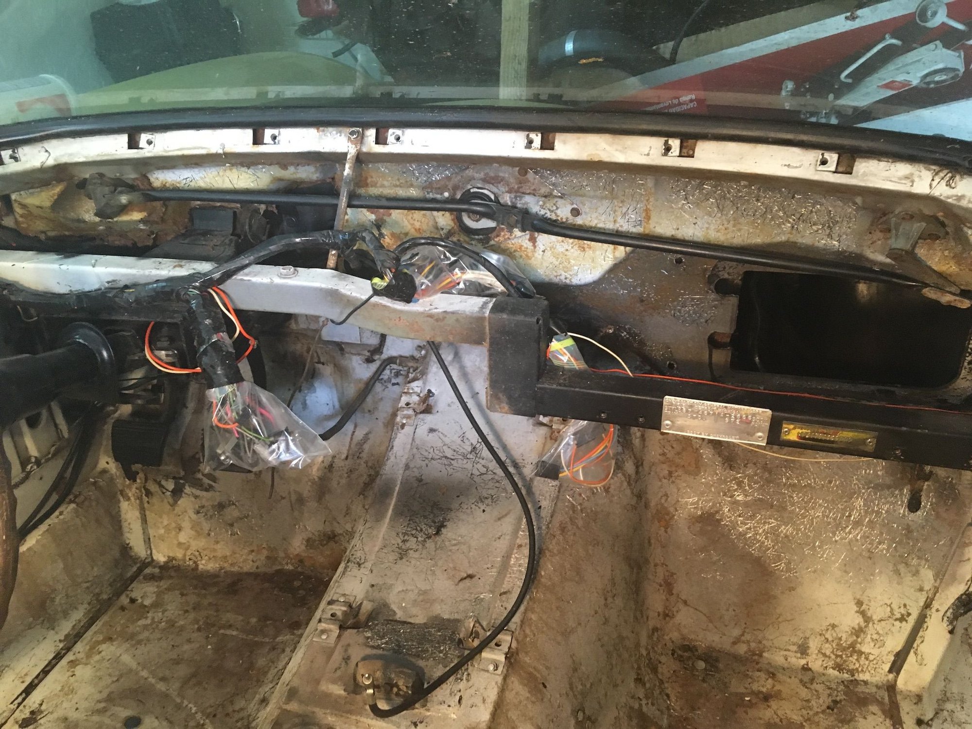

any blue in this area?? I don't see any in this picture.
and in this picture, I only see blue on one side of what looks like a splice, other side looks like only white

not really, I really think your just searching for the answer you want. based on your comments and pics, all behind the dash is white with no evidence of blue, the floors per your comments are only partially blue.
the unbolted parts that show blue could have come off the car that donated the rear clip.
in the late 60's and throughout out the 70's these were just used cars. I'm betting your car was hit in the rear, and the shop that fixed it found it easier to just cut it through the floor and replace all the rear glass, than to replace each damaged panel. the splice looks pretty clear in your one photo.
if its off the frame, unless someone really tried to hide it, I bet the seam is visible. if not visible now, remove the filler from the splice and it will be.
