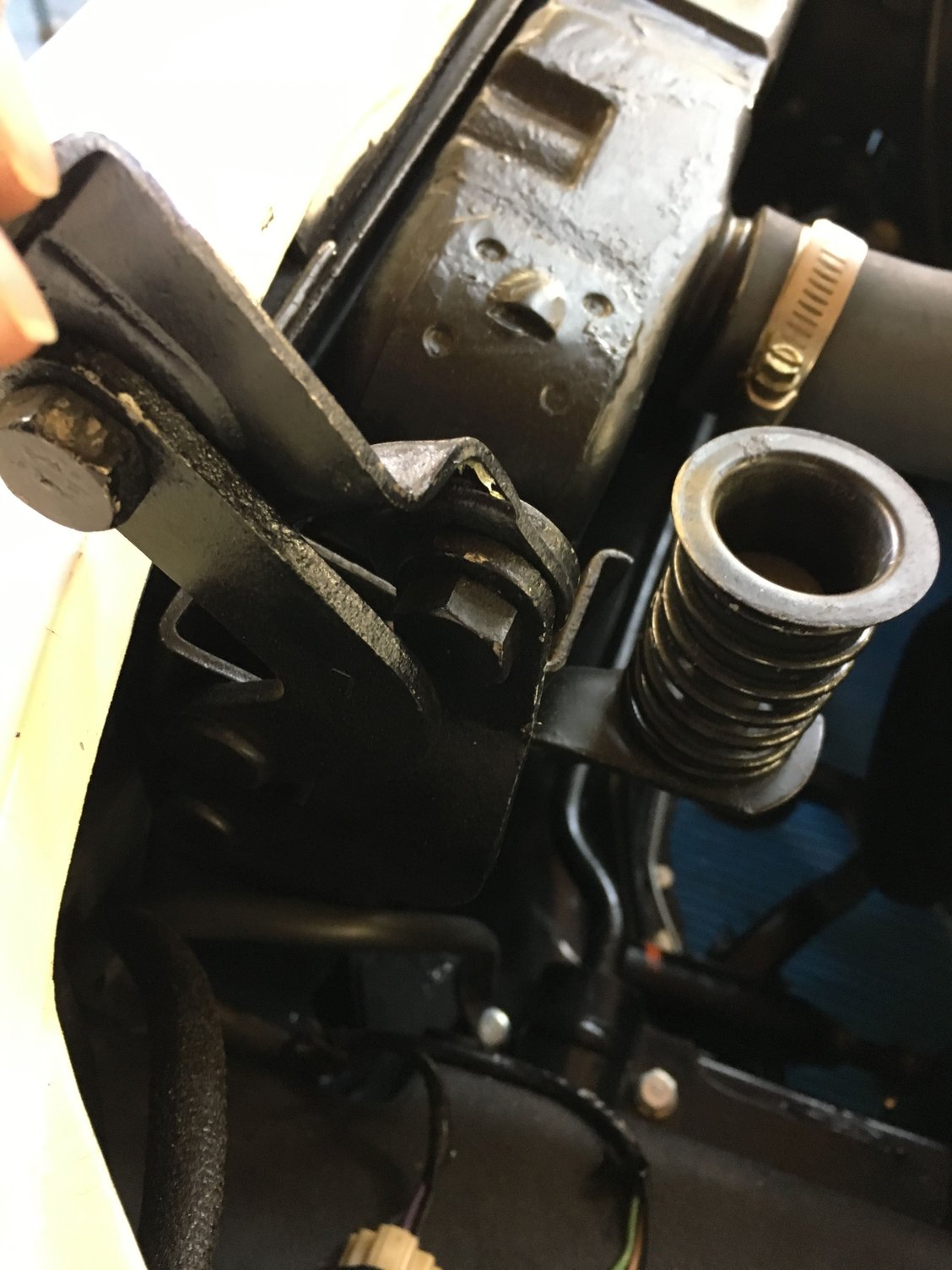

How much slop if any should the hood hinges on my ‘54 have?
I’m thinking of taking them apart to tighten them up. Thanks.

couple things you can do
- hit the two bolts with an impact and tighten them up
- Remove the two shoulder bolts and in-between the arm and the hinge install a very thin wave washer (that is the technical term)
- Or replace the shoulder bolt - I make new ones - if you want a set.

I see what you mean now. I’ll give it a try.

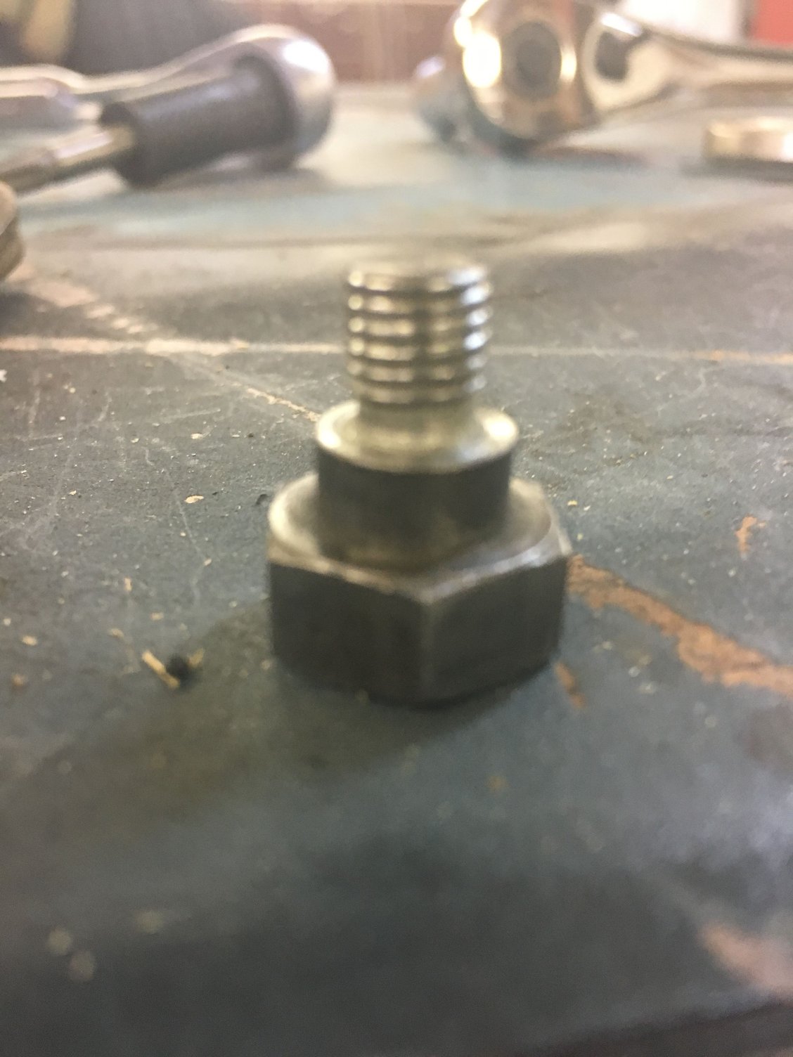

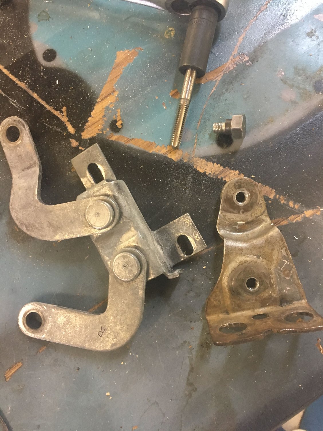

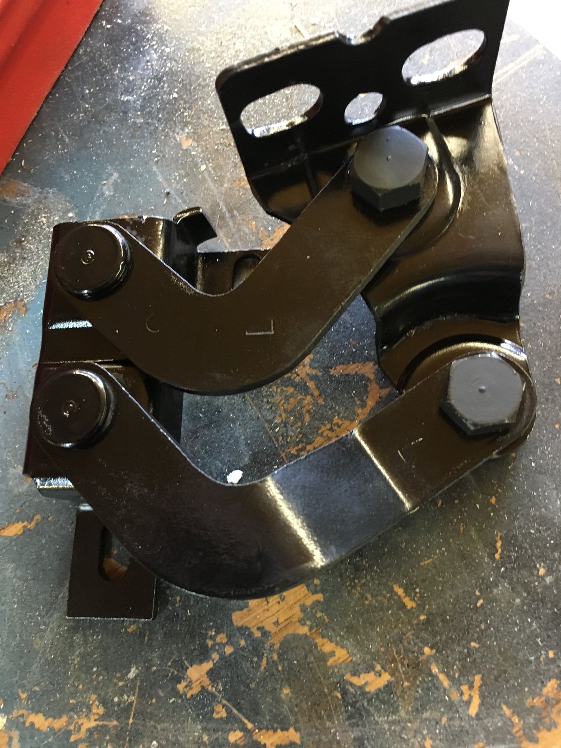

I found the slop, someone used regular bolts in the hinges. It’s just a matter of replacing them with the correct shoulder bolts and a coat of black paint...

Like new.....

Perfect !!!!!!
