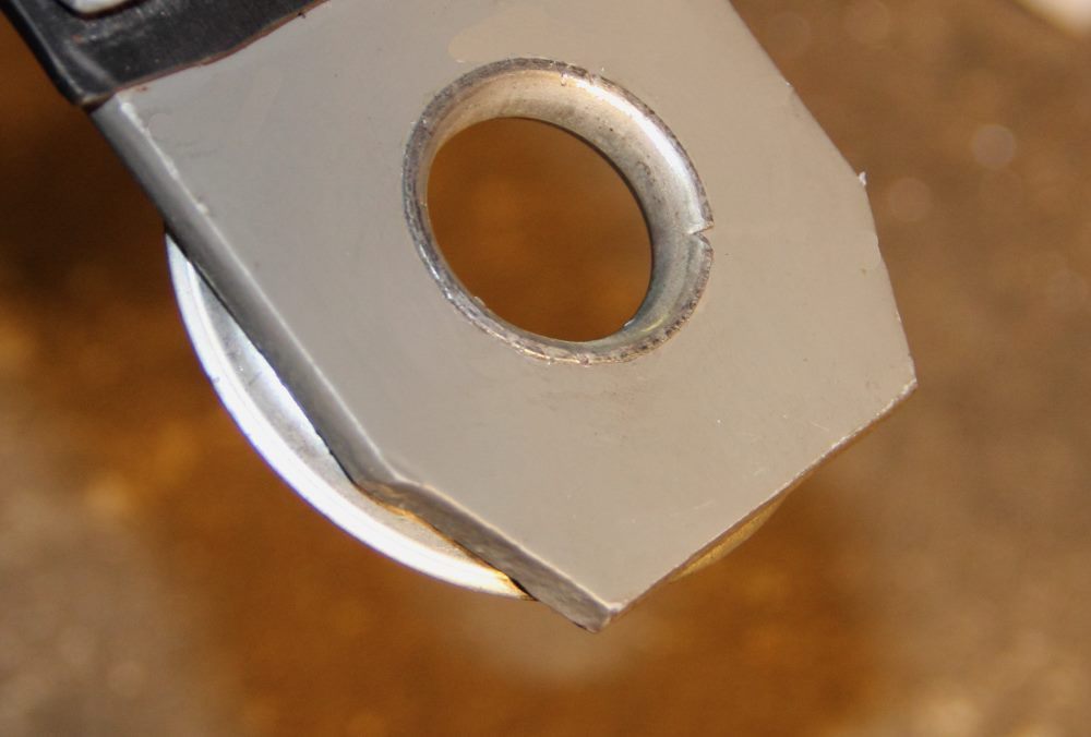

Is this lower cup attached to the spring or should it come out during replacement. It spins freely on the spring but does not want to come out

The lower cup is swaged, preened or crimped over (which ever is more accurate as a description) to secure to the spring. If rusted or otherwise worn you can chisel it out and install a new one. If just replacing the bushings and it's looser than you feel comfortable with, just preen the edges over tight to the spring.

It's rolled over.
Easy to do if you have a press. Use a properly sized spherical object (ball pein hammer, ball bearing, etc) to get the sleeve partly expanded, then move to a larger size (gear shift ball is perfect) to complete the roll over.
Then use something flat to press it down completely flush on the leaf.
A big *** socket works good.

Thanks guys, It looked in good shape so I just used it with the new bushings. Thanks again for the quick replies.
