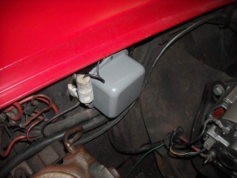

I bought the Advance Auto $22 one. Gray cover. I can live with it. After all, a good look will tell you it isn't original even with an original cover. The base metal is thinner and there are no stampings on the base.
But it works great. The random discharges I was having ceased immediately.
