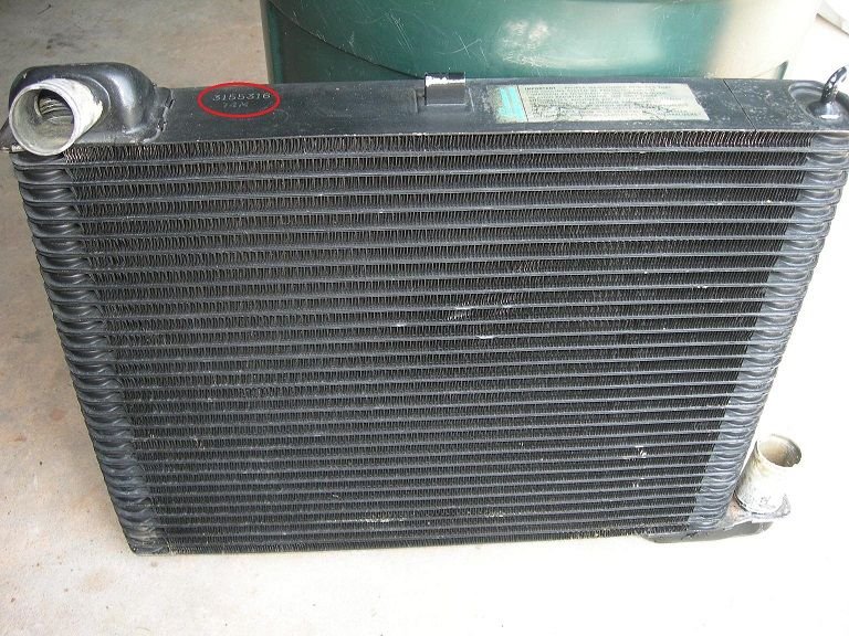

I am pretty sure this radiator is not original to the car but I cant remember if they are dated or not.
If they are, where would I find the date stamp?

All of the aluminum Harrison radiators were dated. The 63-72 had a three digit date, made up of a single letter for the month, and two digits for the year. The date was stamped into the top left of the radiator, just below the part number.

Here ya go

Perfect. Thanks!
Mine is definitely not. Thanks
