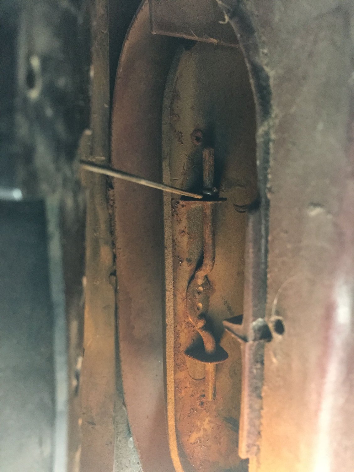

My RH side vent cable handle broke on my 66. I have the new cable, but I can’t figure out how to get the old one disconnected from the vent. The heater box is blocking one of the screws to the vent cover, so I haven’t been able to get that off yet, and I also can figure out how the end of the cable comes off and re attaches to the vent. Any help/pictures would be greatly appreciated. Thank you.

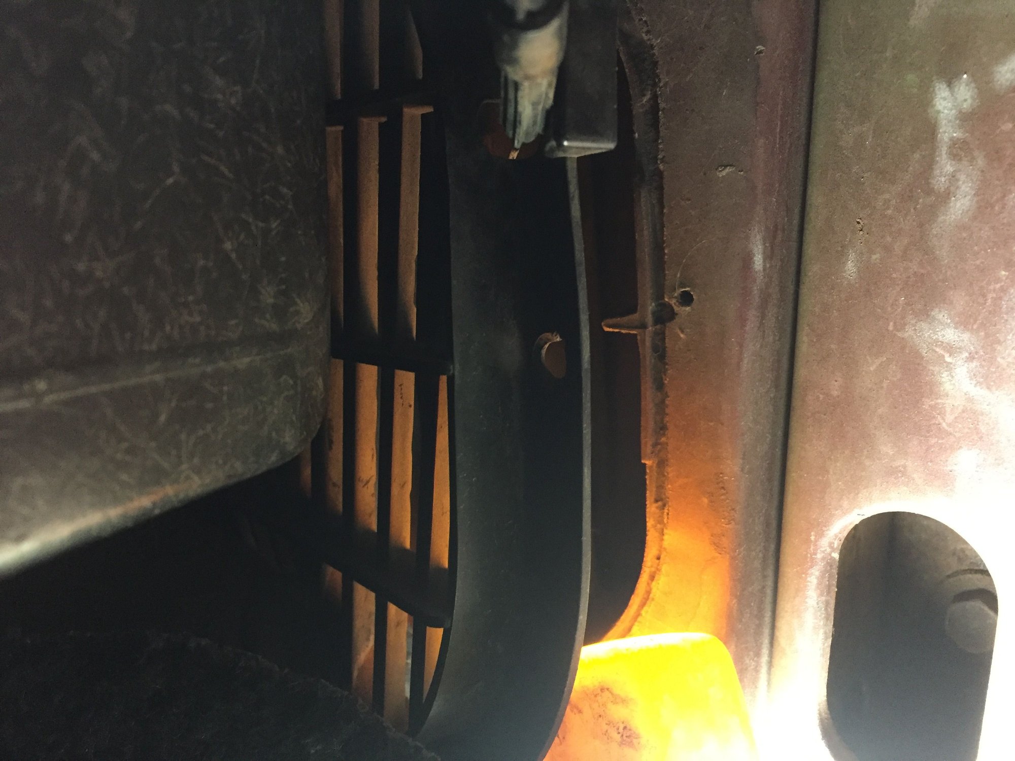

The vent cable should have a wire loop at the end that goes inside the vent grill and over top of a round shaft allowing it to pull the vent flapper door to and fro (open and closed)...there is a small metal nut that goes on the vent door shaft to prevent the loop from coming loose.
The cable housing is secured with a screw to the outside of the vent grill. If its on the PS of the car - yeah it will be a royal PITA to get installed.
This is the driver's side but you'll get the idea...

So, I got the cable replaced without having to remove the heater box and without breaking anything. I removed all screws except for the back one, which can’t be reached. I was able to pry open the vent with it “hinging” on the back screw. I was able to use needle nose pliers to reach in and get it done. I figured that if the vent happened to break, I’d just get a new one.

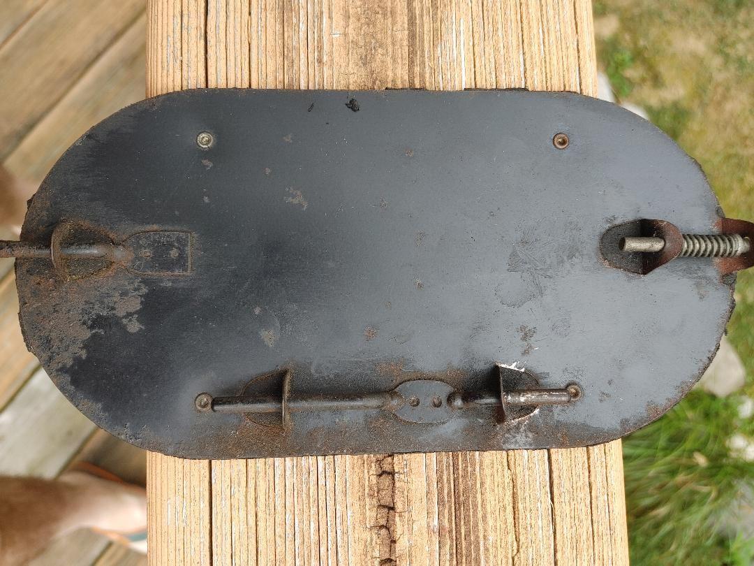

Originally Posted by 1960
Do these vent doors pins pivot in holes in the housing ?
They pivot in holes in the body . . . here's a pic of the passenger side vent door I removed when I recently added VA - the bottom pivot is fixed, the top pivot is spring-loaded! Put the bottom in first, pull the top pivot down and find the hole it fits in! Done!
