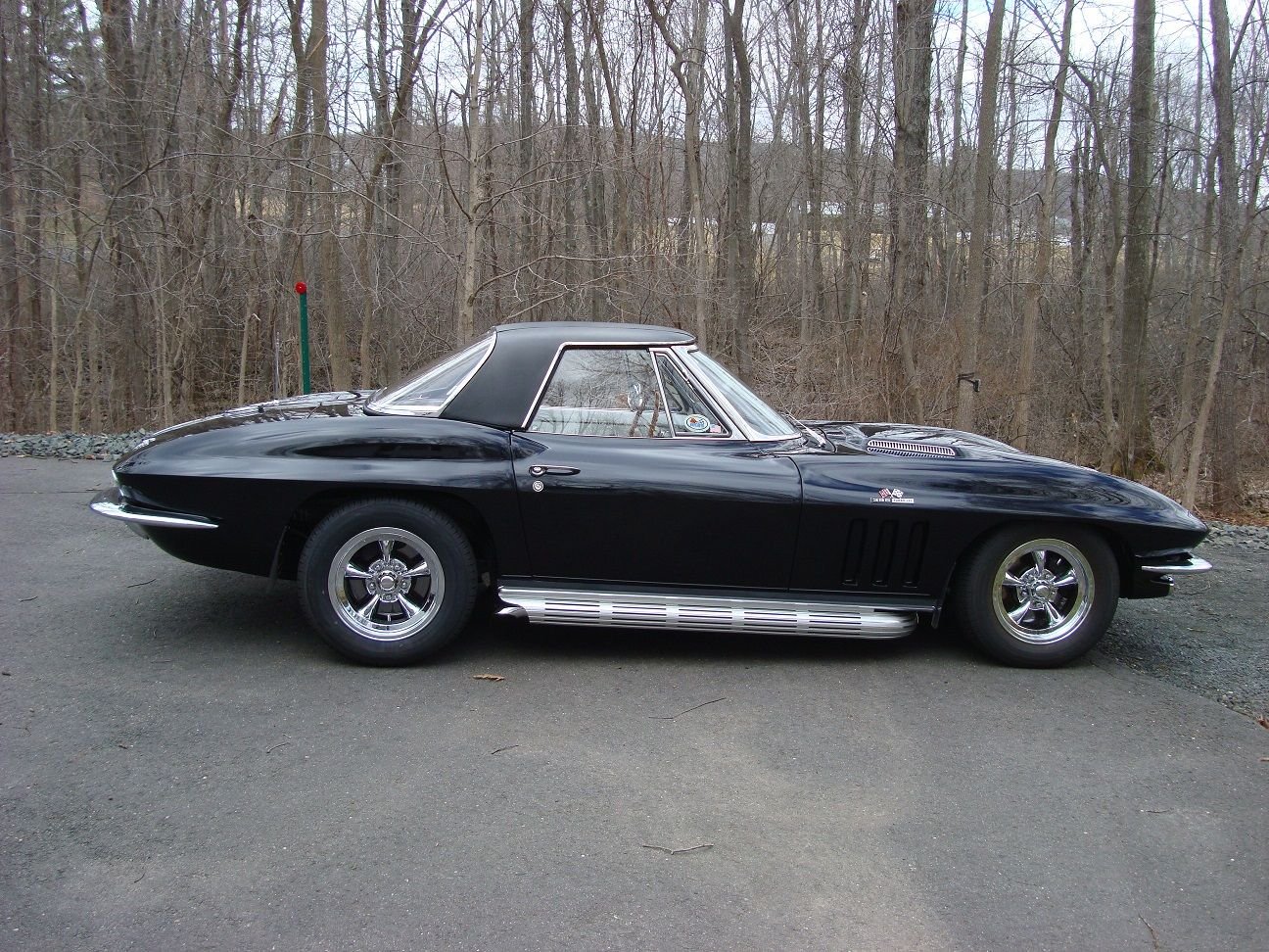

Going to install new tires on my 67. I have cragars so the clearance is not that great, I have 205-75-15's on it now, and like the look of the 75 s as it fills the wheel well. There are not many Brands to chose from now, the Michelins I have on it are now no long made so that brand is out. People have mentioned a Kumho Solus TA11 ( which I have never heard of ) and the Uniroyal Tiger Paw awpii....any suggestions ? advise...etc Thanks..

Be careful with the 75's. I had them on my 65. Initially I had to slightly grind the edge of the lower valance. No big deal. They ran fine for a couple of years. Then I made a hard left turn going into my driveway. The tire hit my fender lip and cracked it. I now run 215/70's from DB. No problems with fender rub.
