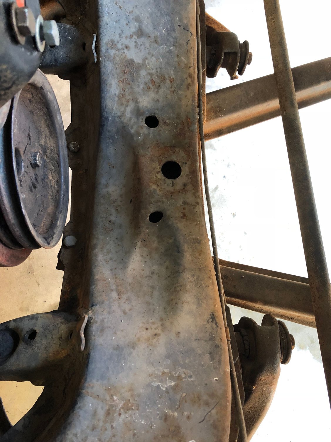

I will be going with a big block, just not sure if 427 or 454. All depends on the best deal I can find. I guess I could still put an electric fan on if I decide. Here's a new question. Is the crossmember in front of the engine supposed to have two humps in it? Also notice that the vertical bracket by the second hump seems high. The vertical bracket on the driver side is flush.

Posts: 3,536
Received 562 Likes on 479 Posts
I can't answer your question about the second depression in the crossmember except I will look at my 67 tomorrow, I don't believe it belongs there but someone here may know.

Posts: 8,801
Received 1,962 Likes on 1,283 Posts
Default Engine is offset to passenger side
You need to keep in mind that the engine in these cars does not sit in the center of the engine compartment, it is offset slightly to the passenger side. Someone here will recall the exact amount, right now it has slipped my mind.
Because it is offset to the passenger side, the larger depression of the two is also offset to the passenger side to clear the Big Block crank pulley's. This has the effect of making the rear, lower control arm pickup point appear to be sticking above the crossmember on that side. In reality the upper surface of the crossmember on that side is lower than the driver's side because of how the tooling shaped the crossmember depressions.
The bottom line is that the crossmember is probably just as it left the factory.
Good luck... GUSTO

Thank you Gustov. I didn’t even notice the offset and now as I look at it it is as plain as day. Any idea what the second smaller depression is for and was this crossmember used in all cars or just big blocks?

Posts: 3,536
I just looked at my 67 corvette and want to put your mind at ease, the second depression you are concerned about is on my crossmember also.
