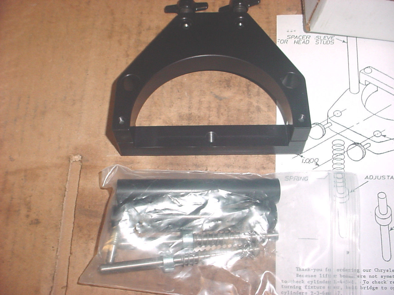

I have one of these to check TDC and to degree the camshaft.

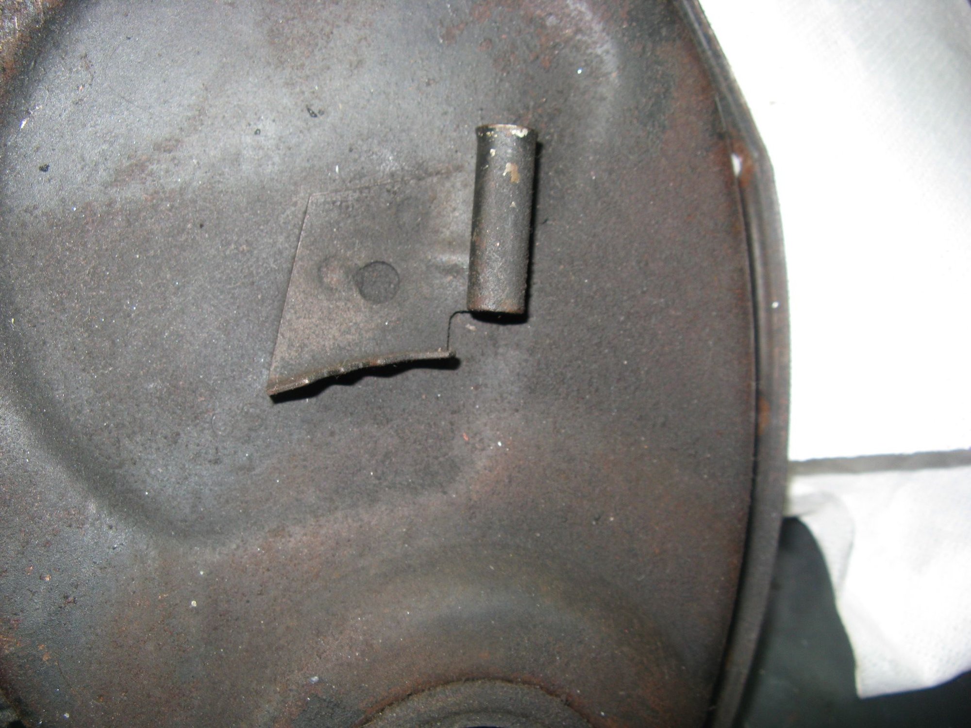

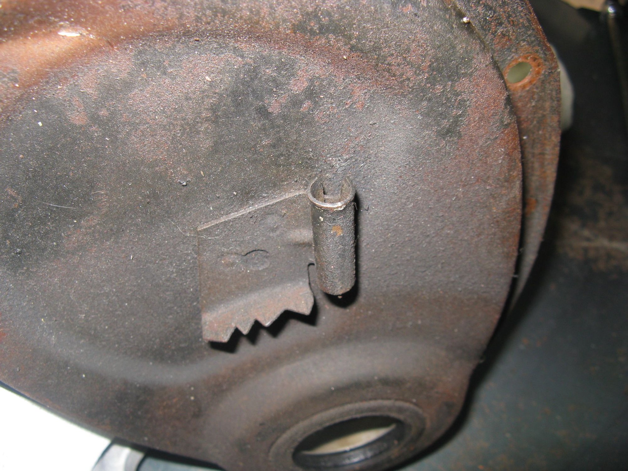

Here is a picture of the timing cover that came with this balancer.
That piece of tubing is a receptical for a magnetic timing probe to eliminate parallax view when setting timing.
Joe

It is as long as the outer ring hasn't slid on the rubber between it and the inner hub.
