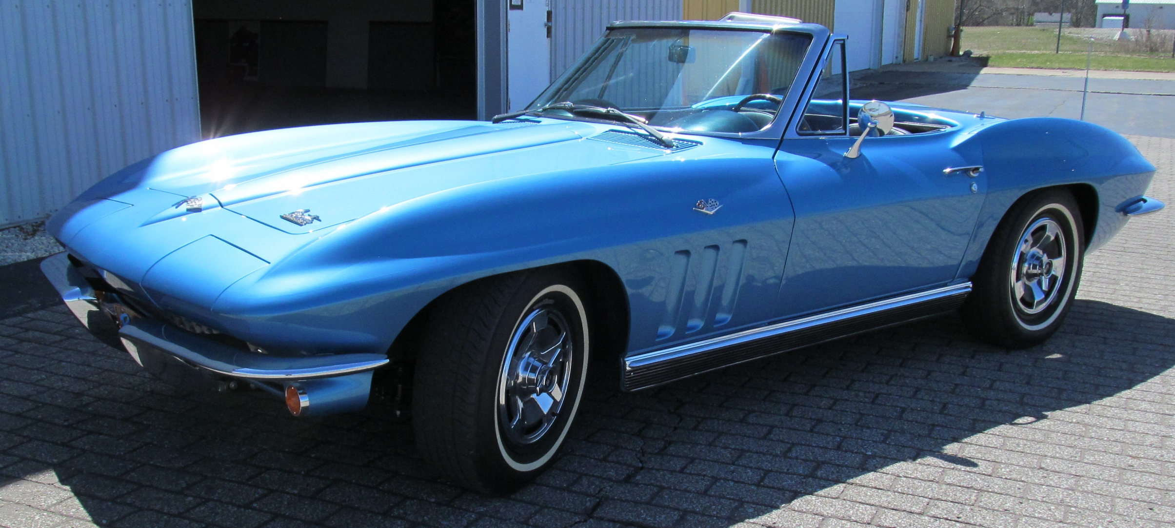

Default '66 Deck Lid Hinge Spring
How difficult is it to install this spring? My deck lid will not stay open all the way.
I have just gotten a '66 and need a shop manual. There are a few available and would appreciate advice on which one would be the best.

Great looking car, Jerry.
