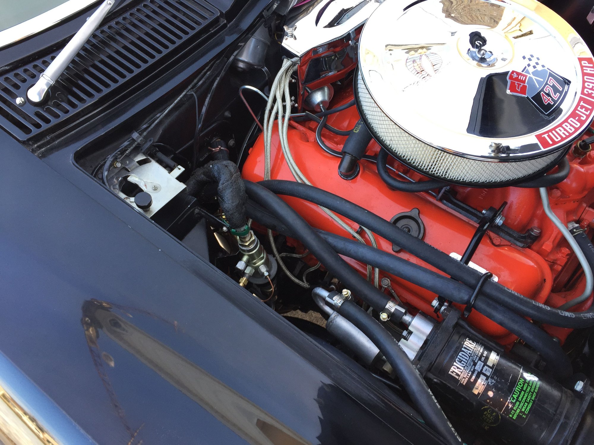

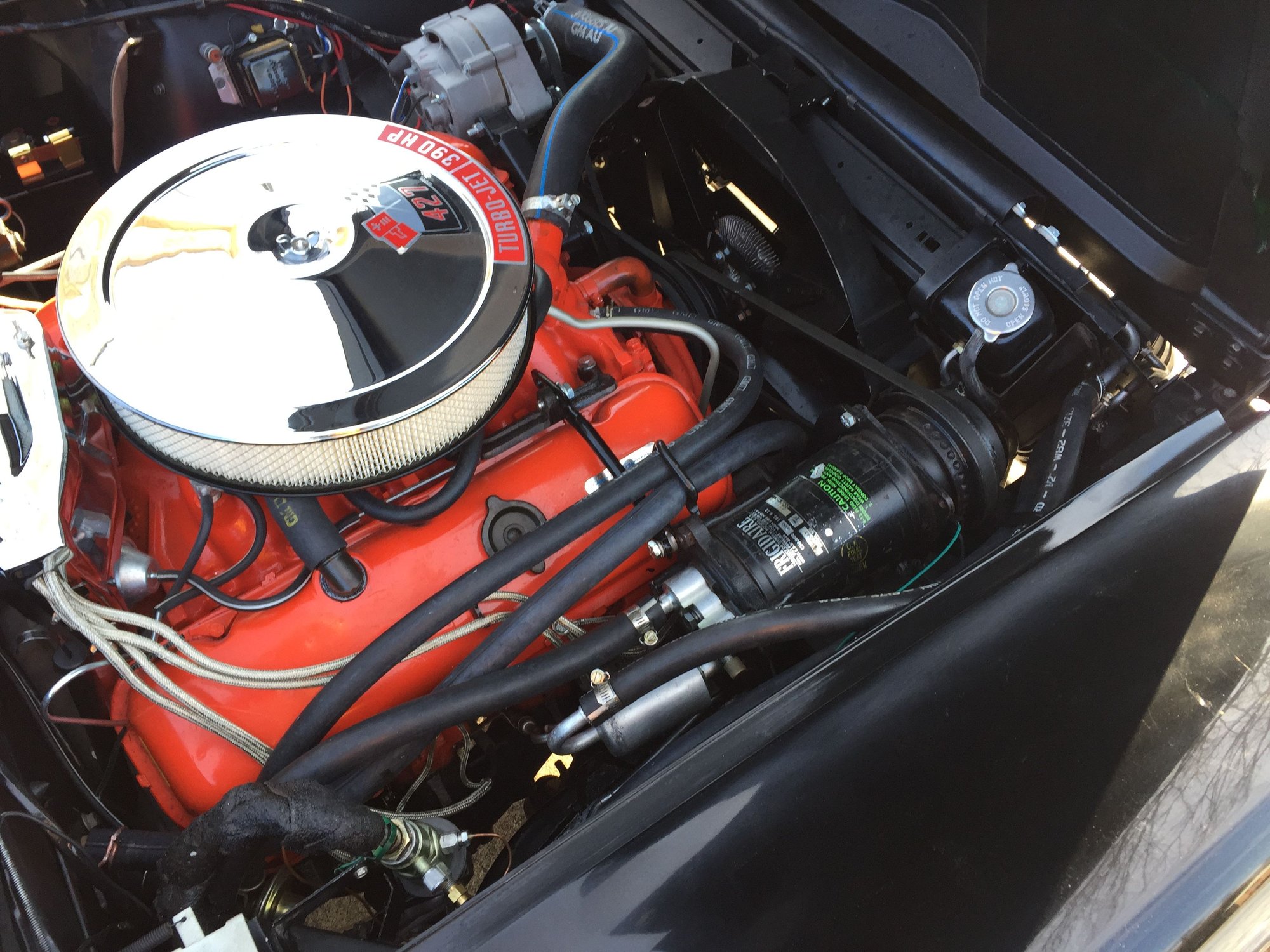

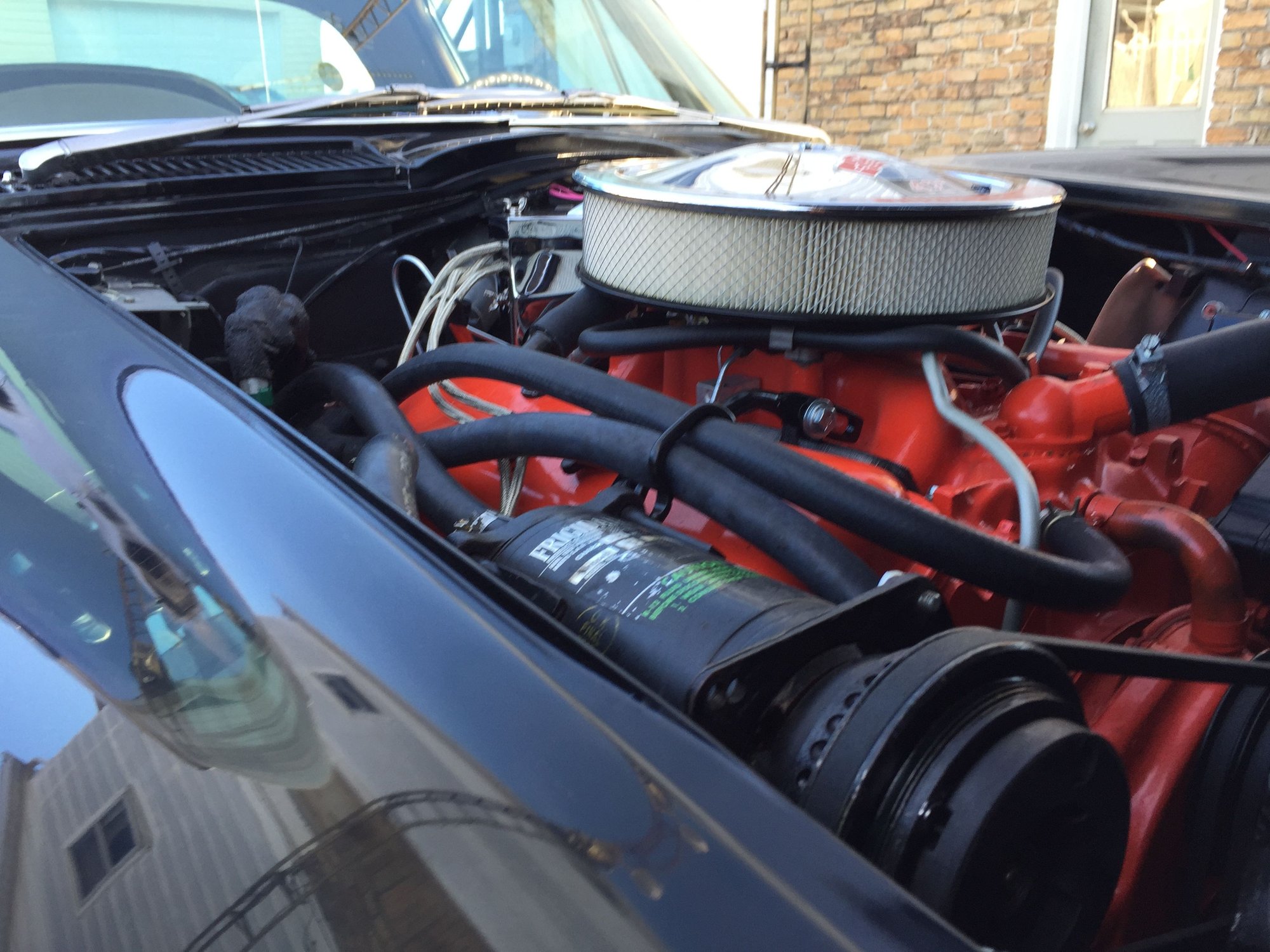

Here is some pictures
And im thinking the P for the washer in the AIM is production washer. Or a common size
