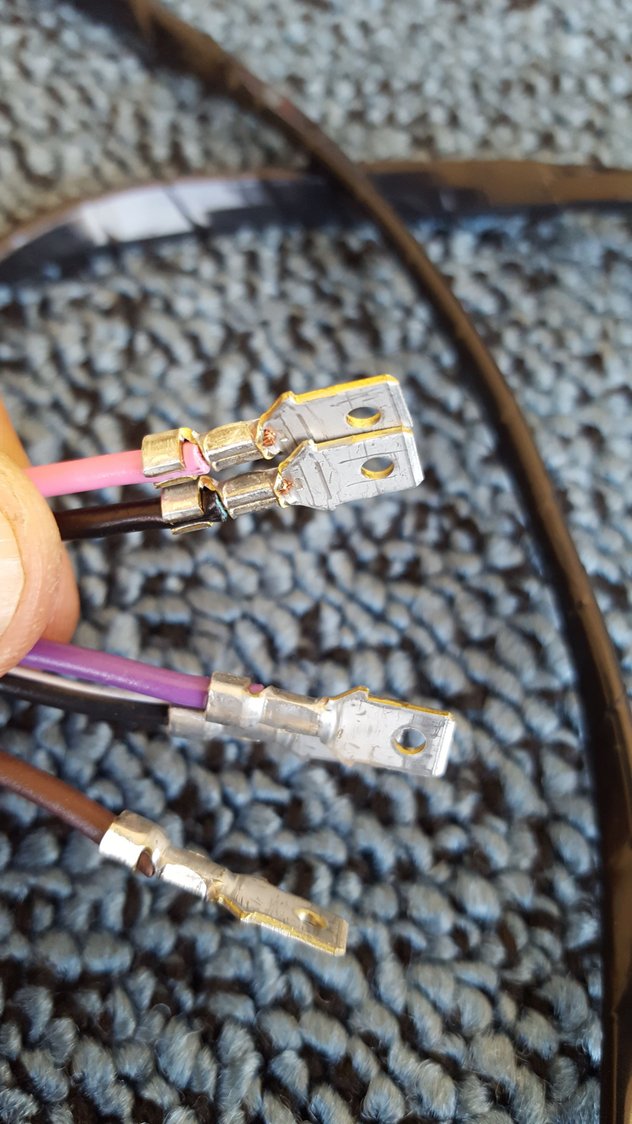

Potentially dumb question...
I'm doing the rear harness on my 61. Is there a trick to releasing the terminals from the plastic connectors? Or do you just yank until they come out?

Thanks Frank. I don't see a tab..
Those C2 connectors look a little more advanced.
From the looks of the terminal on the new harness, I don't see how it could work. unless something grabs the hole in the tab...
Of course it's in the WORST possible place to try to study up close!

The ones you show just pull out. Use a needle nose and make sure you are pulling on the actual terminal, not the wire. Those can be tough to get out after 50+ years. Occasionally I have had to cut the plastic receptacle around the female terminal in order to get the terminals apart.

These are not the turn signals, they are the rear lights, license light, and fuel sender lines from the rear harness. But they probably do use the same connectors.
Already gave them a gentle tug... no dice.
Yes, it's been 57 years on these babies.
I'll give them a pull with the needle nose tomorrow and hope the the best.

Are you trying to remove the male or female (or both) connectors?
The female terminal is the one attached inside the plastic connector. The "TAB" in the picture below is what holds the copper colored metal female connector inside the plastic case. To release this terminal you insert a thin blade inside the plastic case and "flatten" the tab, it should pull out easily with the tab flattened. The male connectors shown in your picture fit inside the female connector and are removed by just pulling them out, using a needle nose pliers if necessary.

I actually got a 2nd wind after dinner and pulled them out with pliers. They came out OK and the new ones attached OK.. so I got lucky!
But now I see I if I ever do the other harness I will need to release the tab from the other side (I was removing the male end this time).
