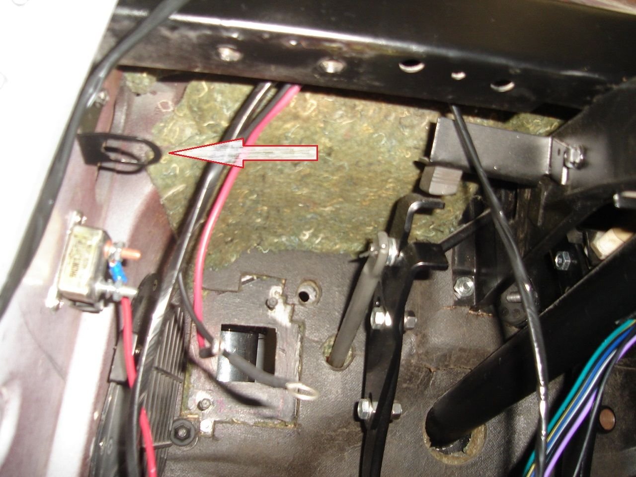

Does anyone have photos of where the underdash courtesy light brackets rivet in place?
I have both assembly and shop manuals, cant find any holes in these areas.
Car door is a 65 coupe.
Thanks!

If you are referring to the interior lights that illuminate when the doors are opened those brackets are held in place with screws not rivets, at least on my 64, I would think 65 would be the same.

also for factory AC cars those brackets are on the AC plastic ducts

yep might have been an ac car, brackets came with rivets so assumed they were riveted on.

My '66, attached with a sheet metal screw.

Many are attached with a small hex sheet metal screw with an "L" logo on the head.
