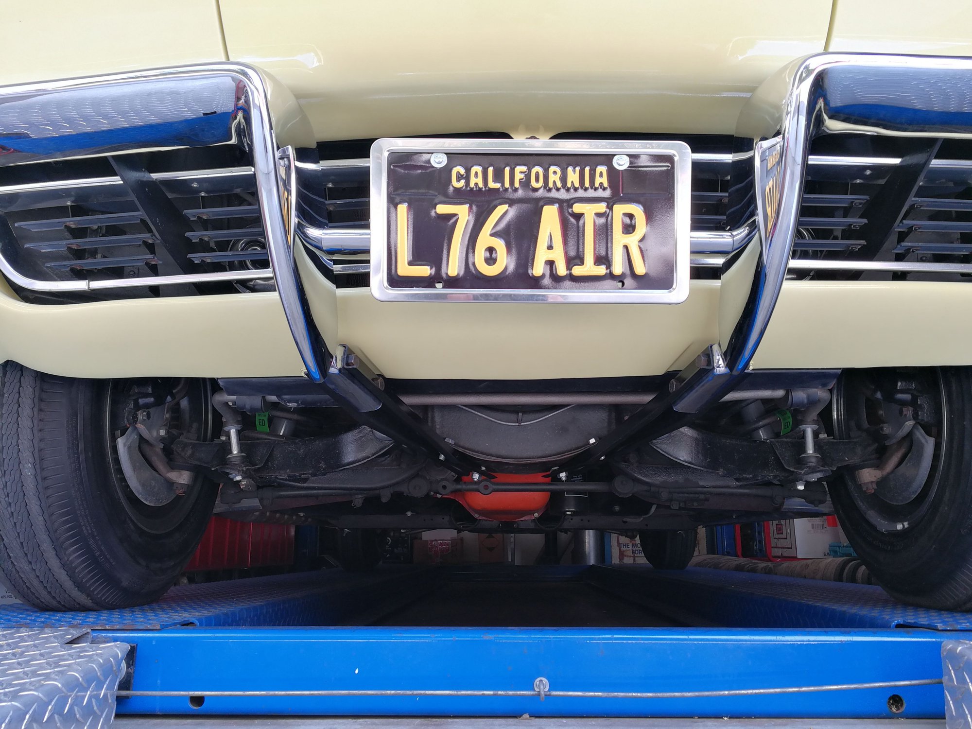

Anybody have any advice, or a good picture, of the level of sheen on original '65 grill slats?

Originally Posted by SW Vette
Beautiful! Thanks a bunch.
Just so you know - You have a '65 L76 Air coupe in Santa Monica? Yeah, if that doesn't provoke envy I don't know what does.
