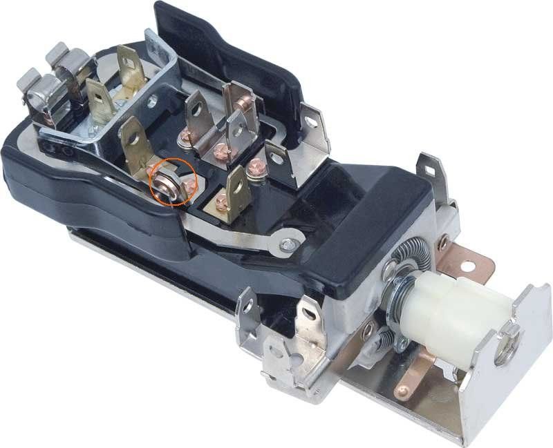

The fuse is a 3 amp fuse for the dash lights. The switch should have a thermal circuit breaker built in. I would still measure for 12 volts to the switch, and if it's there, change the switch.
Here's a picture of where the circuit breaker contacts meet. You can take a look there, but I wouldn't make any modifications for safety reasons.
