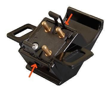

Maybe I'm misunderstanding, but you shouldn't have to break off anything to disassemble the switch. It should come apart by moving the clip holder slightly so it clears the "nubs". Then snap back together.
Press in at the two holes to release clips:
You are right, I removed the back of the connector as it seemed to not be making contact with the pins on the switch. I tightened up the three brass connectors inside as I thought that may have been the problem.
Ended up it was the switch it's self.
Thanks for the correction - Sorry about the confusion.
