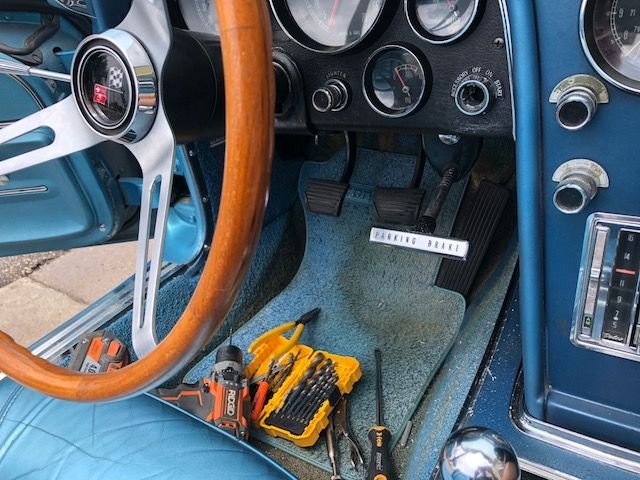

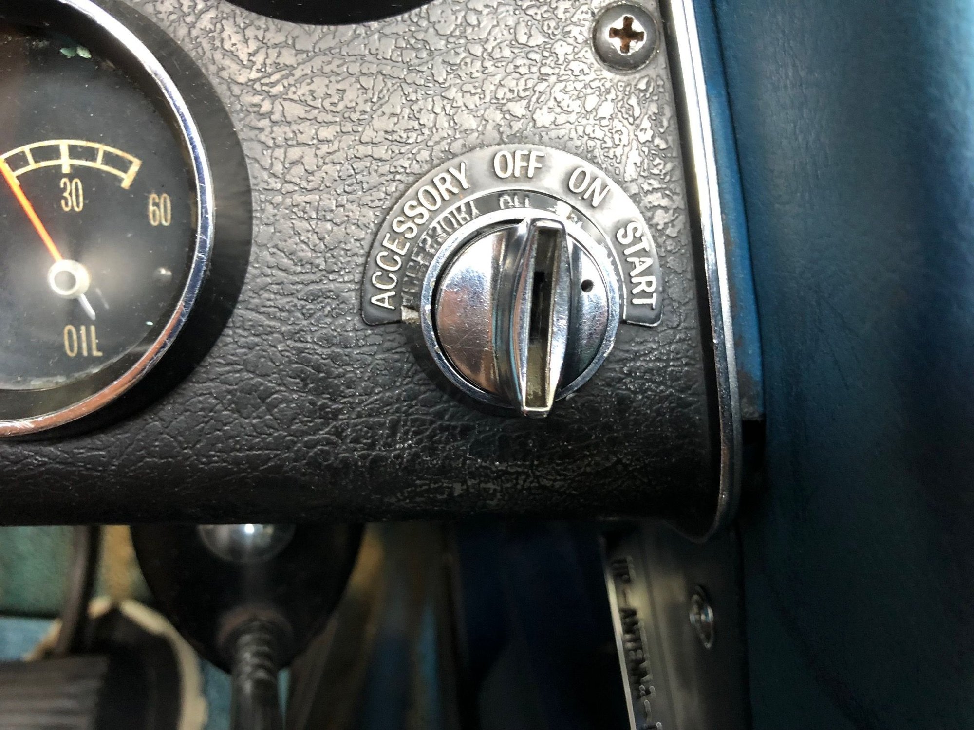

Bought a new lock for the ignition switch on my 66 because the switch only turns to the right and starts the car without the key. So when I went to change the lock, I noticed that I have the wrong switch. Look at the thing. Anyone have any idea where it came from?
I tried to use a paper clip to remove the lock but that didn't work. Nothing gives when I push on it. This may be because I don't have the proper key to turn it to the left. So how do I get the switch out?
Obviously, I need to buy a new switch so I went online at Paragon Corvette and the description for the switch said 'replacement style'. I plan to have my car judged in the fall and want to buy the right switch. Can anyone recommend where to buy one or is the one at Paragon the one I need?
Thanks in advance for the help!

To remove the lock, you'll have to have the key that allows it to turn to accessory, then push in the button in the hole with a paper clip and turn a little further. If you can't even turn to accessory, the release hole won't help.

Reese, as others have mentioned, the ignition switch (lock) you have currently appears to be the '63-'64 lock. You will need to get the switch into the ACC position in order to insert the "pin" - to release the lock. If you know a locksmith they can pick the lock quite easily to enable you to get it to the ACC position.
My first car was a '62 impala and I quickly learned that simply wiggling the key and turning it, would unlock the switch, with or without a key, any GM key that fit the lock.
You may be able to remove the bezel and slide the switch out the back of the cluster. Just remove the electrical connections and take the switch to a locksmith to remove the lock from the switch.

To drill out the old lock, do I just drill where the tinny hole is?
If I find an NOS or good working ignition switch, I can just install the new lock that I bought from Paragon and I'll be good to go, right?

Originally Posted by Reeseb
Thanks for all the help!
You can't just drill through the hole. It has to be lined up by going to accessory and then the hole lines up with the little push button. Your first choice is going to have to be to get it to accessory somehow .

I got the switch drilled out and the lock pulled by a locksmith today. Now I just have to buy an NOS switch and hope that the lock I bought at Paragon fits it.
