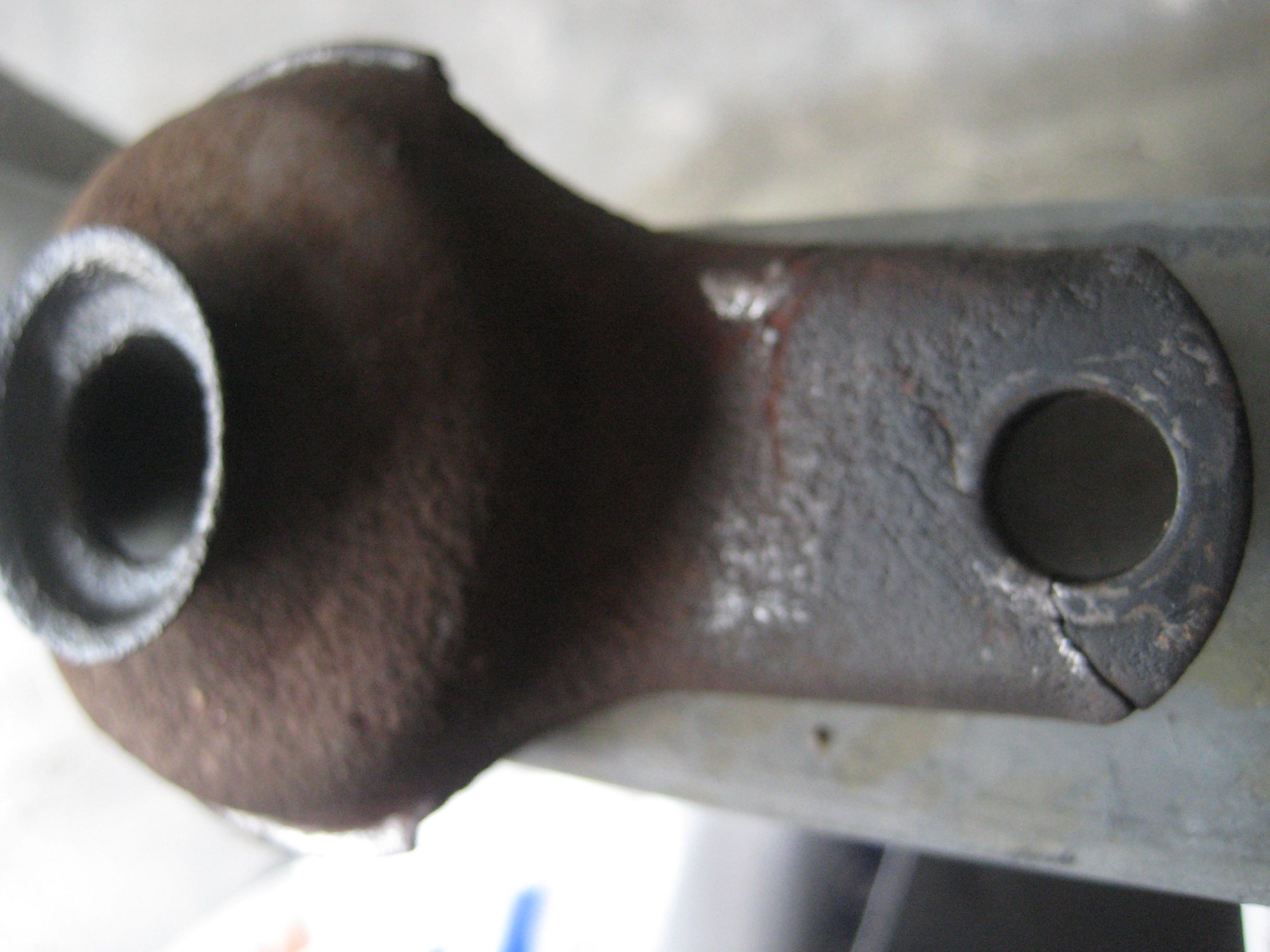

These are center-link, kingpin, live-axle cars......you can get the ride decent with Monroe or Delco shocks and good radial tires - you don't need anything more exotic and don't go down the road of stiffer springs if yours are fine. You should have a front sway bar (I don't know if the earlier C1s had rear sway bars) and if the rubber is gone on the end links and bracket then replace those... Look VERY carefully at the lower front shock mount tabs - they are notorious for cracking and if so - repros are availabble. See picture.

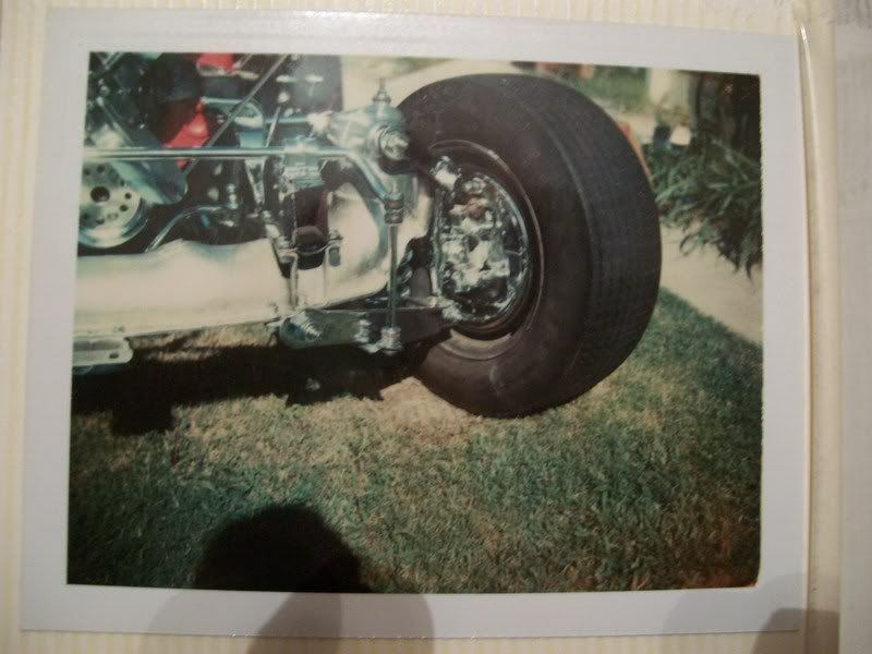

This is the auxiliary front sway bar that was available from the Chevy Parts dept.
This 62 was originally a Gulf Oil racer and restored by Rev Mike Ernst. DAMN, I hate that he sold it!!!!

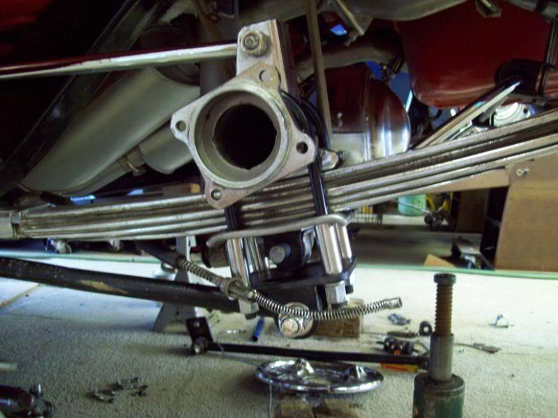

This is not the best picture (I took it over 45yrs ago), but it shows the 60-62 style front sway bar without the notch. If a better comparison of 53-59 and 60-62 front bars is needed, I MAY have one of each out in the other building that I can take a picture.

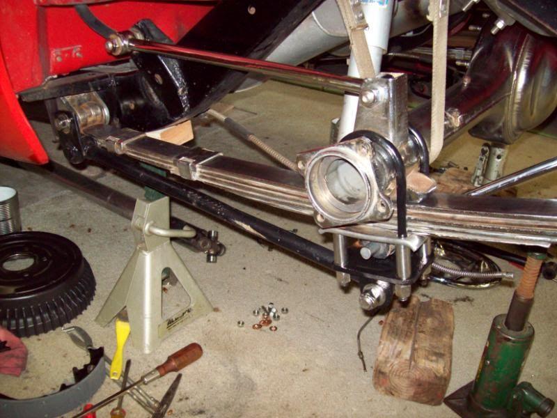

This shows the bracket which has to be welded to the frame for the factory 59-62 traction bars (radius rods).

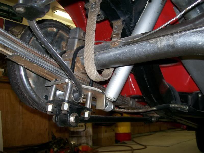

I also added Traction Master lower traction bars. Thus, longer U-bolts were required as well as spacer tubes, to permit attachment of the brackets under the shock mount plate for the rear sway bar.

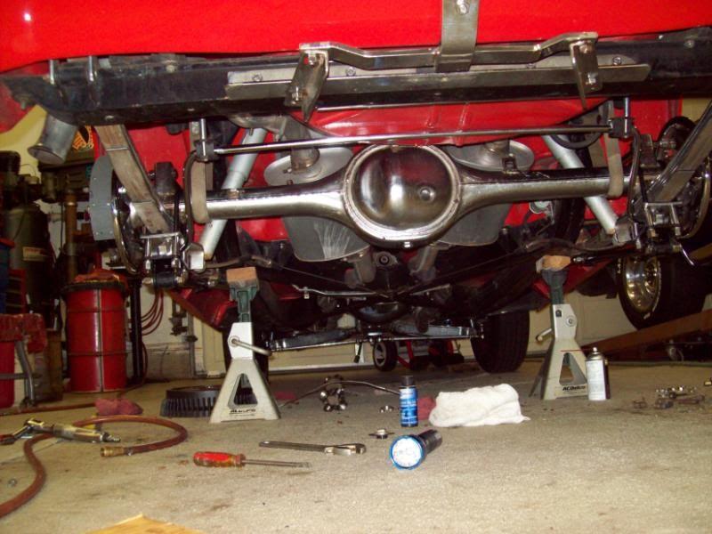

The bracket on top of the axle housing is on ALL 59-62 axle housings. Otherwise, to add the traction bars, a bracket would need to be welded to the axle housing (MUCH simpler to round up a 59-62 housing). A LOT of people have done restomods and upgraded to their 62-earlier chassis, so it may be fairly easy to locate a good buy on these parts.
This shows the 60-62 rear sway bar and the bracket which has to be welded to the frame.

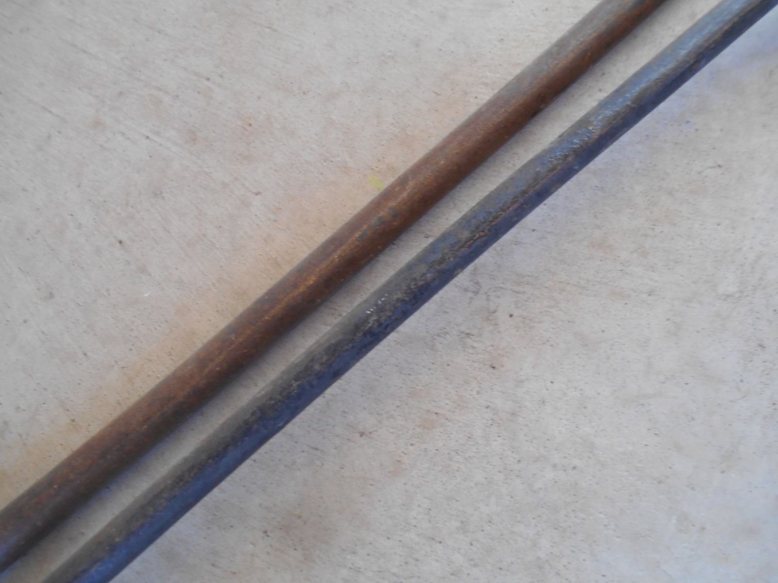

Found them.
Here is a comparison of the 53-59 front bar (notch), and the 60-62 front bar.
And a comparison of the thickness of the 2 bars.
