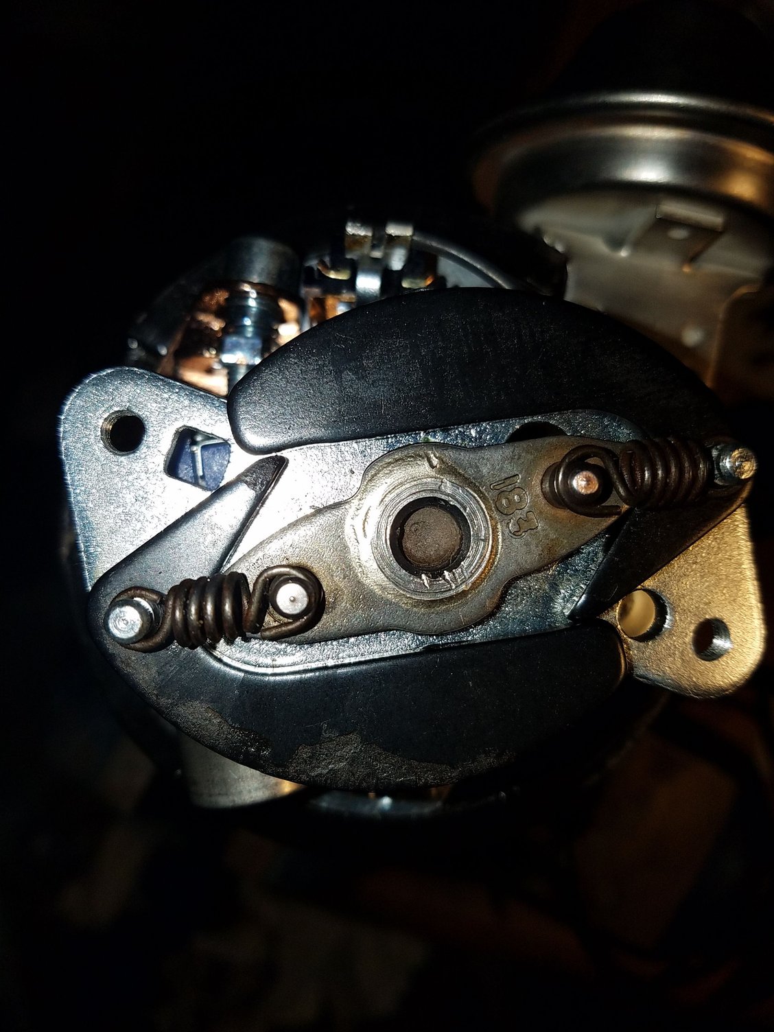

Just installed a brand new distributor. For a 327/300. As a final check, I twisted the rotor and let go. It didn't snap back.
I have removed the entire distributor again and it still doesn't snap back. The weights just expand and then stay that way.
Is this a manufacturing issue - or will it loosen up after if runs for a few minutes?

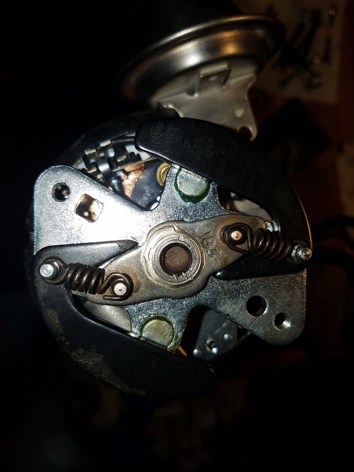

Thanks guys. I realize how late it is for you. It's only 8:30 pm here in Seattle.
I just ran outside again and (per your suggestion) added some 3-in-1 oil between the long plate (where the springs attach) and the larger plate underneath it. While it does move a little bit easier, it still doesn't "snap". I manually twisted it about 30 or 40 times trying to loosen it up.
It appears that the long plate is pressed onto an upper shaft (?). Could this have been too tight? I don't know where, or how that upper shaft connects.
I'm going to try to attach a video that I just took. Oops won't accept it. Wrong file type.
So here's a photo instead.
Weights are "closed".
Weights are "open".
I can only get these two positions by twisting the long plate.

Those are some strange springs. Take them off and see if the shaft and advance plate move freely versus one another. If so, don't bother disassembling further. I have found that no aftermarket springs come even remotely close to OE GM springs. Way too long or low a spring rate in any case.
There is always a little play in the weights before the inside of the leg hits the advance cam, but they should always snap back to neutral when you twist the assembly with the springs on.
Forget about the weight and spring kits from Mr. Gasket and others. Go online to McMaster Carr and buy a length of stainless extension spring stock, and make your own springs with a set of side cutters and pliers.

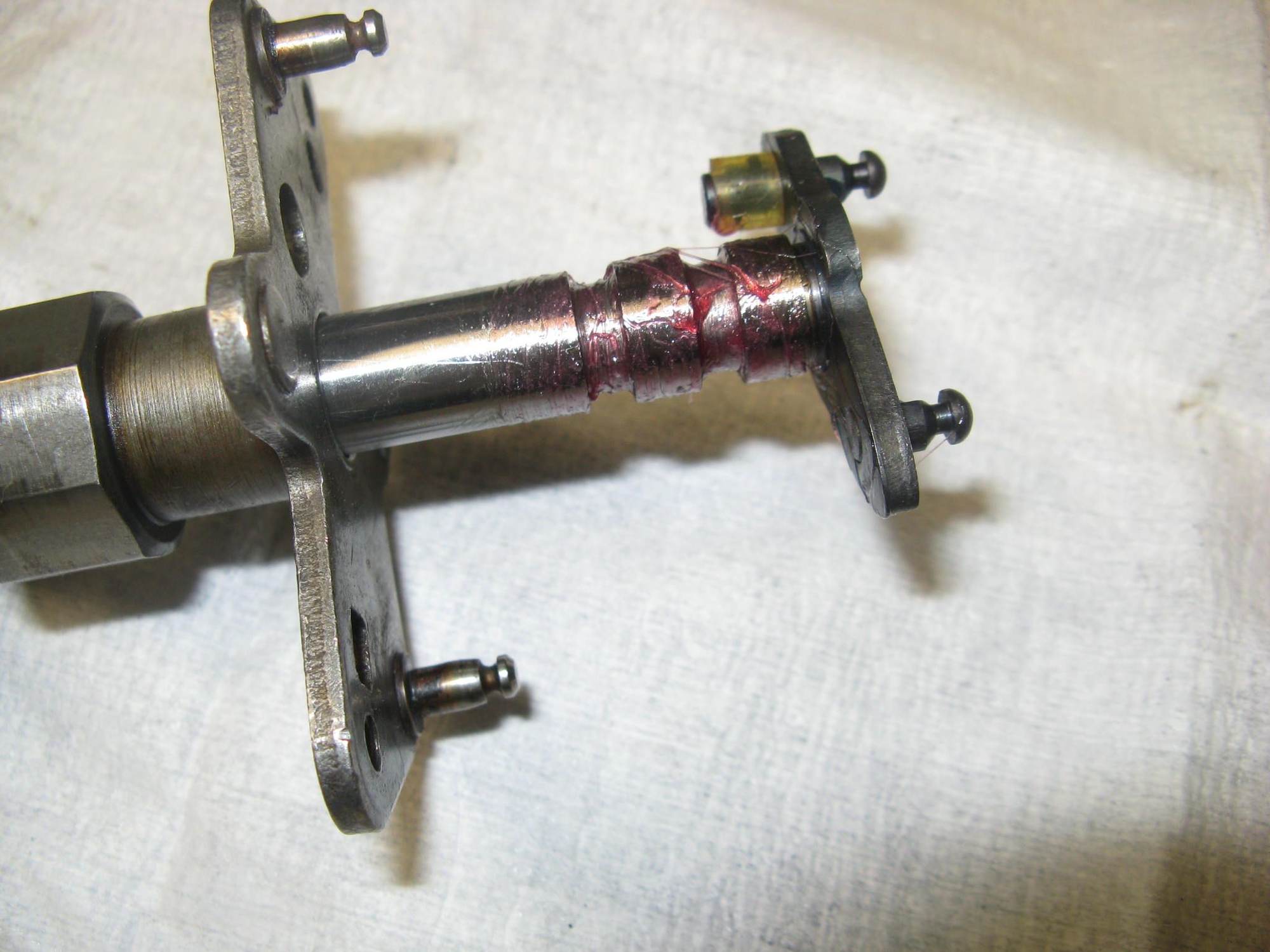

Those spring look like small coil springs! They should snap the weights back quickly.
As stated I would take the shaft out of the distributor and see what type of grease was used in the area in my picture.
If you want I could send you an article I wrote on distributor reconditioning which will help you disasemble and assemble it.

Those springs are gonna be way too stiff for all in at 2500. If those springs can't pull in, then the lighter ones needed aren't going to either.

Those springs look like they came off a dump truck. What are the centrifugal specs? What's the number on the VAC? I suspect that this "new" distributor was rebuilt from a junk OE distributor with junk aftermarket parts, and your best option is to return it and find someone who can supply you with a properly rebuilt distributor with a spark advance map that is suitable the 300 HP engine.
