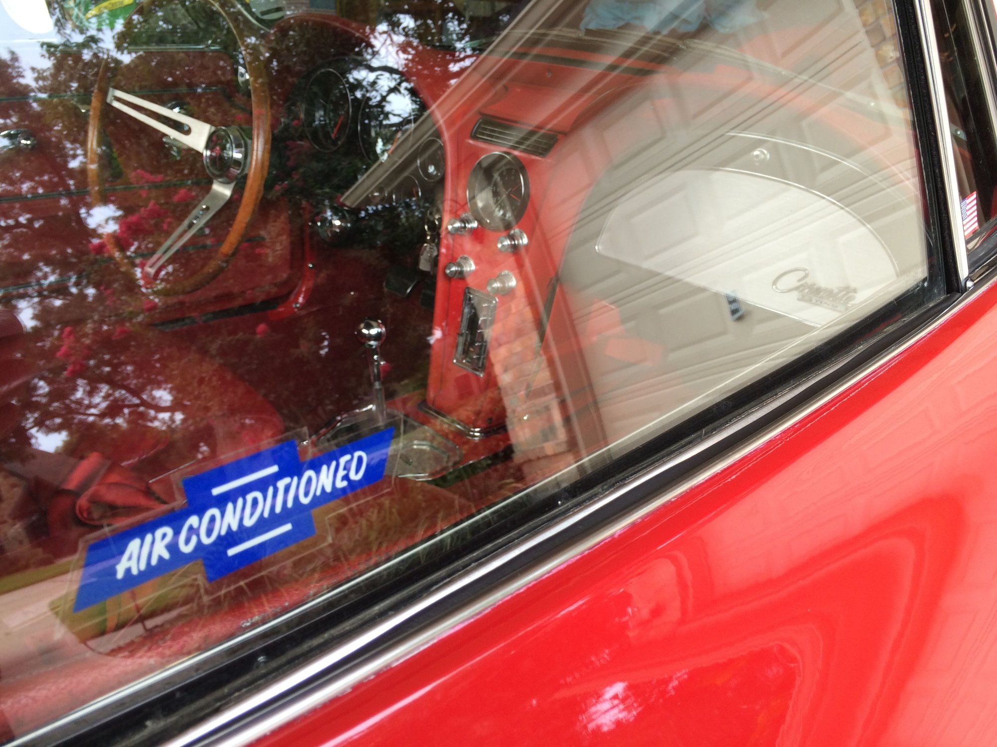

I've seen some remove the clock on the cars and run an A/C round nozzle through the opening....as to installing a factory style center vent - I don't know if anybody reproduces those or originals are around. I added a center vent to the steel dash (like factory) in my Chevelle and it was a bit nerve-wracking but it did just fine and looked decent..
Seriously though - if you're worried about air distribution the Vintage Air does the job without the center vent:
