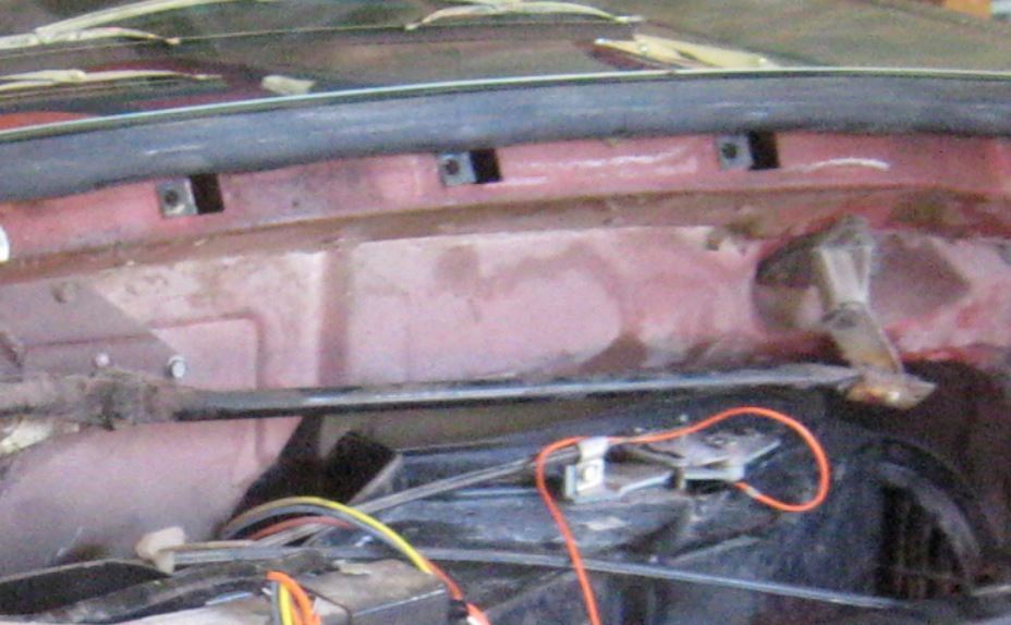

Well -- here is what's behind there if it helps:
My thought is that the nut on the back is stripped and forcing some upward pressure on the bolt head would get it past that area.... I don't know if you can get to the back of this area to hold the nut while loosening the bolt..

Looks like a clip. Do you think it broke and the remaining half is just spinning? And that did help. Thanks

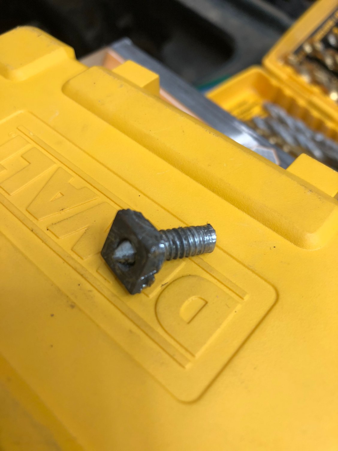

Thanks John. I stuck the dremel up there and the wheel is to close for comfort. I’m got my endoscope out to see what was there and it looks like a beveled square nut that was arrached to the clip at some point. Getting the wrench and drill now.
Old Jul 20, 2018 | 09:43 PM
elwood13's Avatar
elwood13
Joined: Jan 2018
Posts: 4,755
Likes: 2,375
From: McKinney Texas
Victory! Thank yo so much John. Post up son current pics of car when you get a chance.
And the culprit.
Looks like Bubba was there before you were!
