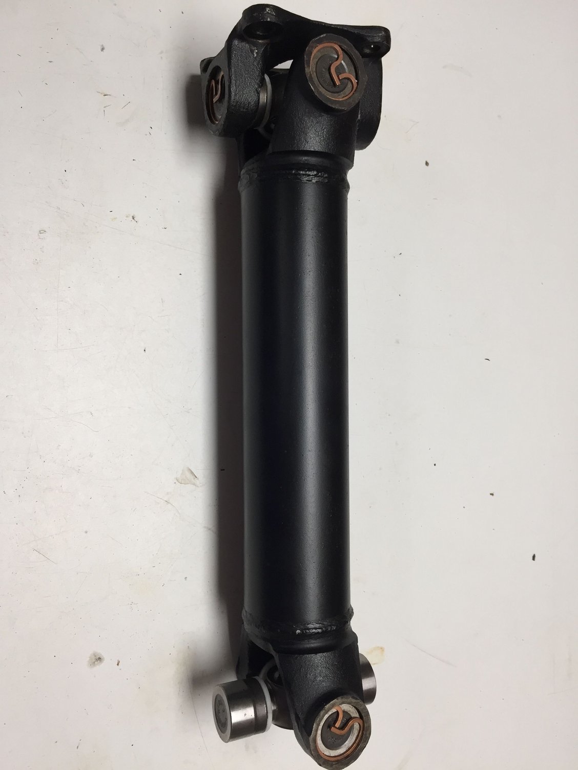

Here's P.S. Years ago I was into powder coating everything I could and did the half shafts and driveshaft. I was happy to see they looked as good now as they did 15 years ago
