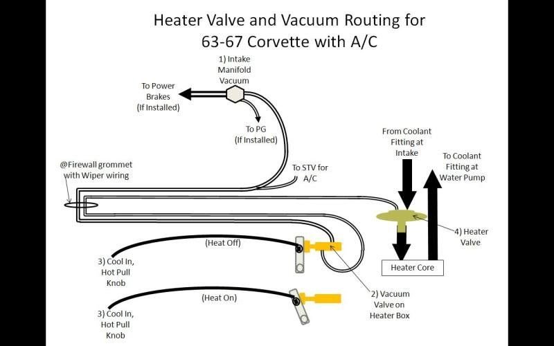

I would first check to make certain that the hot water valve on the inlet to the heater box is CLOSED. Valve is located under the hood on the passenger side near the rear of the engine. It has a attached vacuum line. Valve is/should be closed when no vacuum is present on the vacuum hose.
The next step is observing the levers on top of the heater box from inside the car under the glove box to make certain they move when you pull/push the AC console *****. It is possible that some of the internal insulation strips have fallen off from age and are blocking the doors from opening and closing. The Chevrolet Service Manual on AC has excellent drawings and troubleshooting information. That way you can read and see what the inside of the heater and AC boxes look like and where these doors are.

Be sure you install the correct valve..........that is closed with no vacuum, and requires vacuum to open. There are very similar valves being sold that operate just the reverse These were for the later C3 cars. So double check what you have to be sure.
Larry

I agree with all of those above that have directed you to stop the HOT water from entering the heater core. I would remove the heater hoses at the fire wall and either plug the ends or get a nipple that will allow you to connect the two ends together and run your system and enjoy the cold air. Many years ago, I had the same experience as you, a working system and no cold air. I took my 67 to a local Chevy dealer and watched as the service man checked my system. All pressures were OK, the compressor, evaporator and all ac valves were working within spk. No cold air. The dealer was no help.
I returned home and got out the service book and found out about the vacuum controlled water shutoff valve. I removed the vacuum line that was attached to that valve and plugged it with a nail. Started the car and the cold air was wonderful. The hot water that was being supplied to the heater core was killing the cold air.
