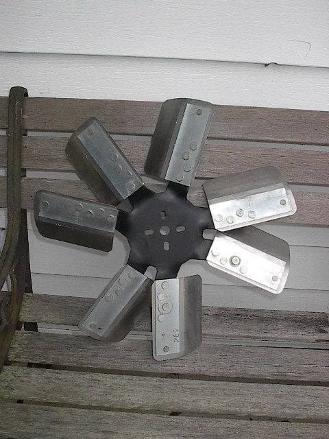

I have a restoration DeWitts aluminum radiator in my '61, with a 427 CI small block, 180* T-stat, and clutch driven 7 blade Z28 metal fan with the factory shroud and it cools fine.
Before I bought teh new rad, i called DeWitts and asked what the BTU transfer rate was on that radiator and also what the transfer rate was on a '67 427 BB radiator. The BTU rating were almost identical.

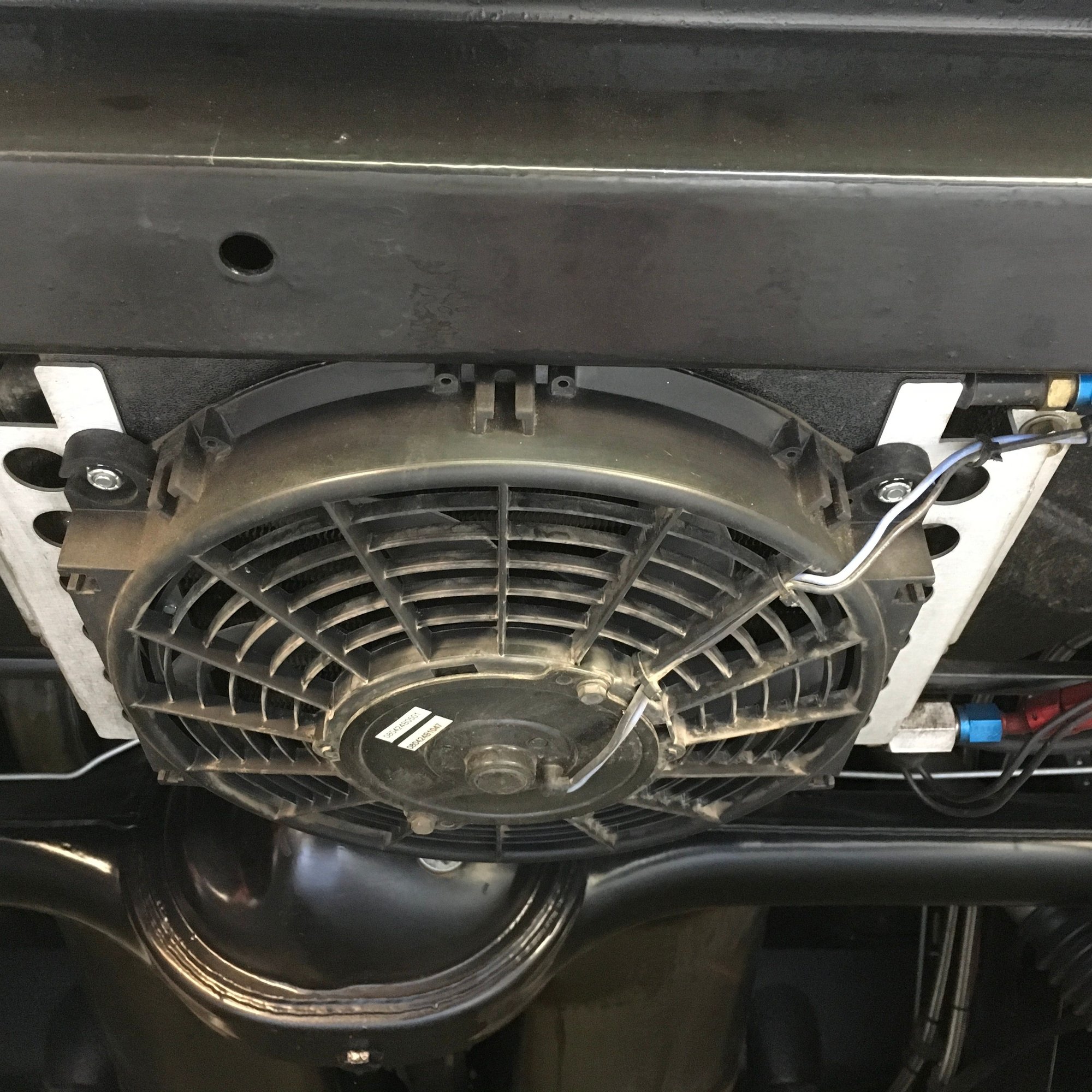

It is a full size cooler (not an auxiliary as by itself it would not be enough cooling) with a dedicated thermostatically controlled fan. Here is a picture:

Thanks for the pic. Not familiar with these type of fluid coolers. could I ask the brand name and maybe where you got it from.

The cooler is a Derale from Summit Racing:
https://www.summitracing.com/parts/der-13720
And the thermostat control is also from Derale:
https://www.summitracing.com/parts/der-13021

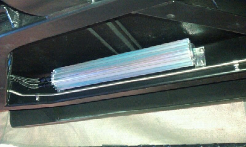

Be sure to check the actual engine temperature at the sending unit, heads, intake manifold and block with an IR sensor before you do anything. I see that you said you have an additional Autometer gauge installed...The IR sensor is quick, easy and inexpensive to verify actual engine temp...
As Factoid said earlier...Texas heat is BRUTAL!...If you decide to go with an automatic transmission here's a picture of the transmission cooler on the inner frame rail of my '59 restomod...The LS3 engine has a 187* thermostat...Runs between 185* and 195* in South Texas summers.
Wolfman
