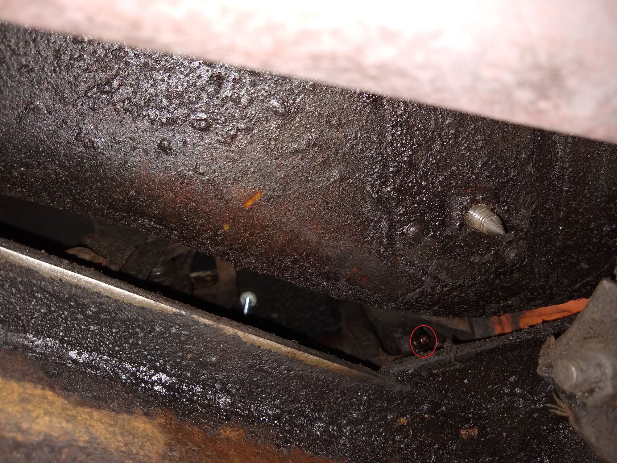

Maybe this is old hat, but I did a pretty deep search and could not find this.
If you can get the car off the ground (I used jack stands), you can grease the U-joint at the front of the drive shaft.
Ramps (front or back) won't work because it's right in the middle of the car (ask me how I know!)
Put the car in neutral so you can turn the driveshaft while under the car.
Turn the shaft until you can see the zerk.
Sneak the end of the grease gun through the narrow passage.....
