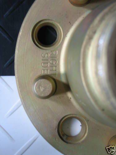

The pins are just slid in there. they shouldn't be hard to pull out. Did you try the part I said about moving the spinners slightly one way or the other to loosen the pin by making the hole larger? If it's too late for that your only choice is to drill the pin out. If the holes on the adapter and the holes on the spinner aren't lined up to make a circle they pinch the pin and make it hard to pull out.
Just to let you see what I am dealing with. The spot were the pin is as shown on the right upper corner. That little white dot. I tried hitting the spinner with a lead hammer but no luck
yet.
Old Sep 8, 2018 | 02:30 PM
65GGvert's Avatar
65GGvert
Joined: Jul 2006
Posts: 22,198
Likes: 4,185
From: Kannapolis NC
looks like it might need to move counterclockwise very slightly. Looks like it may be hitting against the pin on the upper left of the circle. you should be able to drill that out without hurting the adapter if you're careful.
