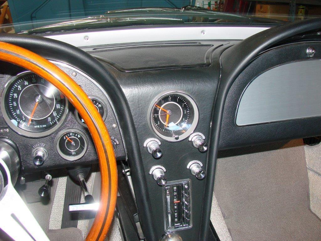

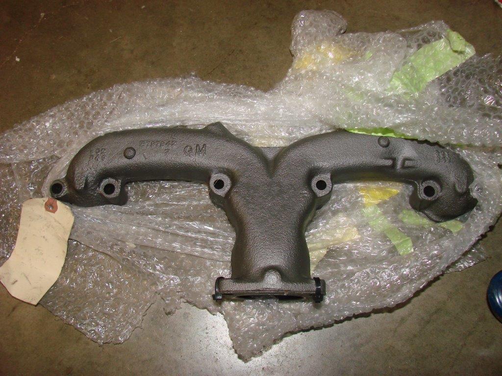

I am headed down the same road, getting ready to install A/C in my 64 small block coupe.
I bought a factory A/C dash at Carlisle to take advantage of the center A/C vent.
I have already relocated the alternator to the driver's side. Next up is to install the factory A/C exhaust manifold on the passenger side (I got a great deal on the correct manifold at Carlisle). Still undecided about moving the battery to the driver's side. Apparently not a necessity with the Vintage Air system.
I am also undecided on the actual compressor that I will use. I want to keep the under hood "looking" stock, as least to the casual observer, so an ALMA Products new A6 compressor (with the dual front seal) may be used instead of the Sanden compressor. I am weighing the pros and cons of this decision.
I also have to figure out how to "engineer" my controls, since the factory A/C dash also has the two extra holes for factory A/C controls. There are lots of options there.
I am wondering (and I know I need to contact Vintage Air about this) if I should order the kit for a factory A/C car. I wonder what assumptions are made by Vintage Air with that kit over the non factory A/C kit.
Plenty of research still left to do.

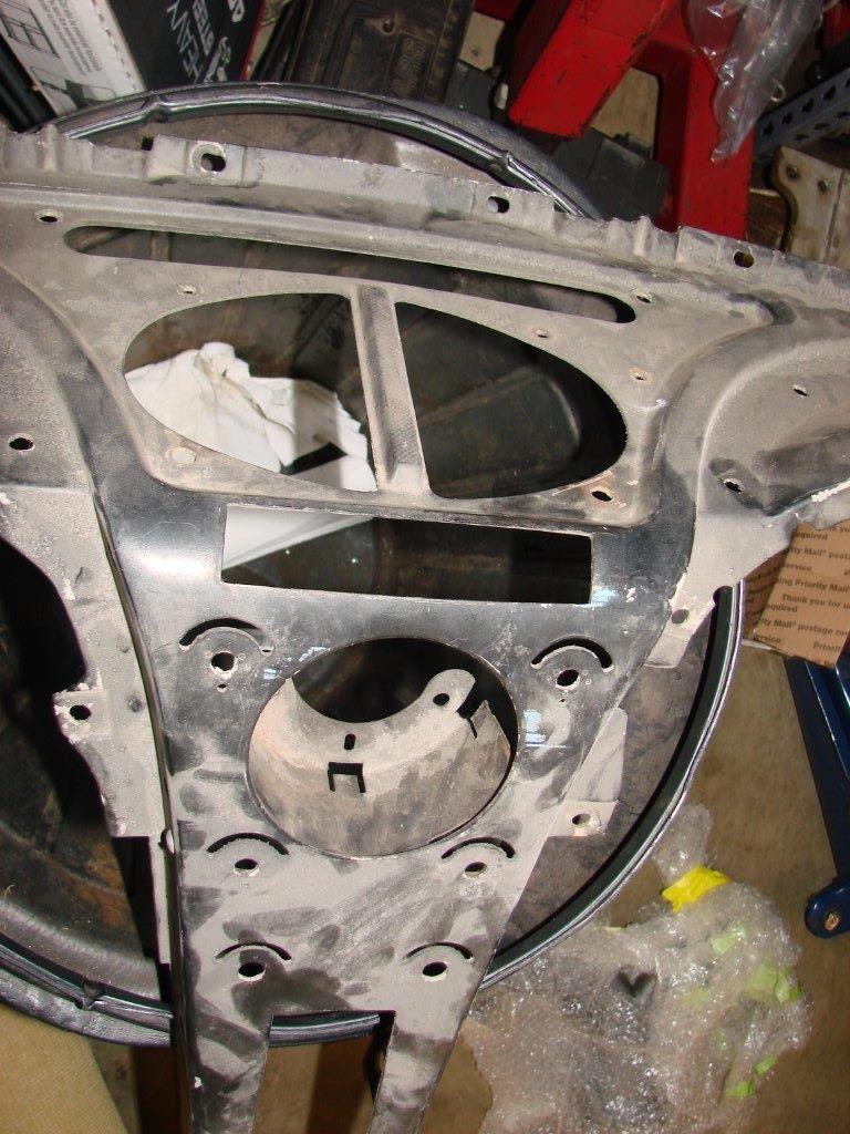

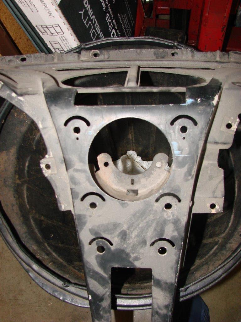

I will pull the entire dash when I do this. My dash is in nice shape, and I just noticed that the previous owner did not have the dash ends painted body color. I won't either until I decide on whether or not I will replace the hood.
I need to take a close look at the C60 section of the 64 AIM, and see what all I will need to change / modify / whatever.
